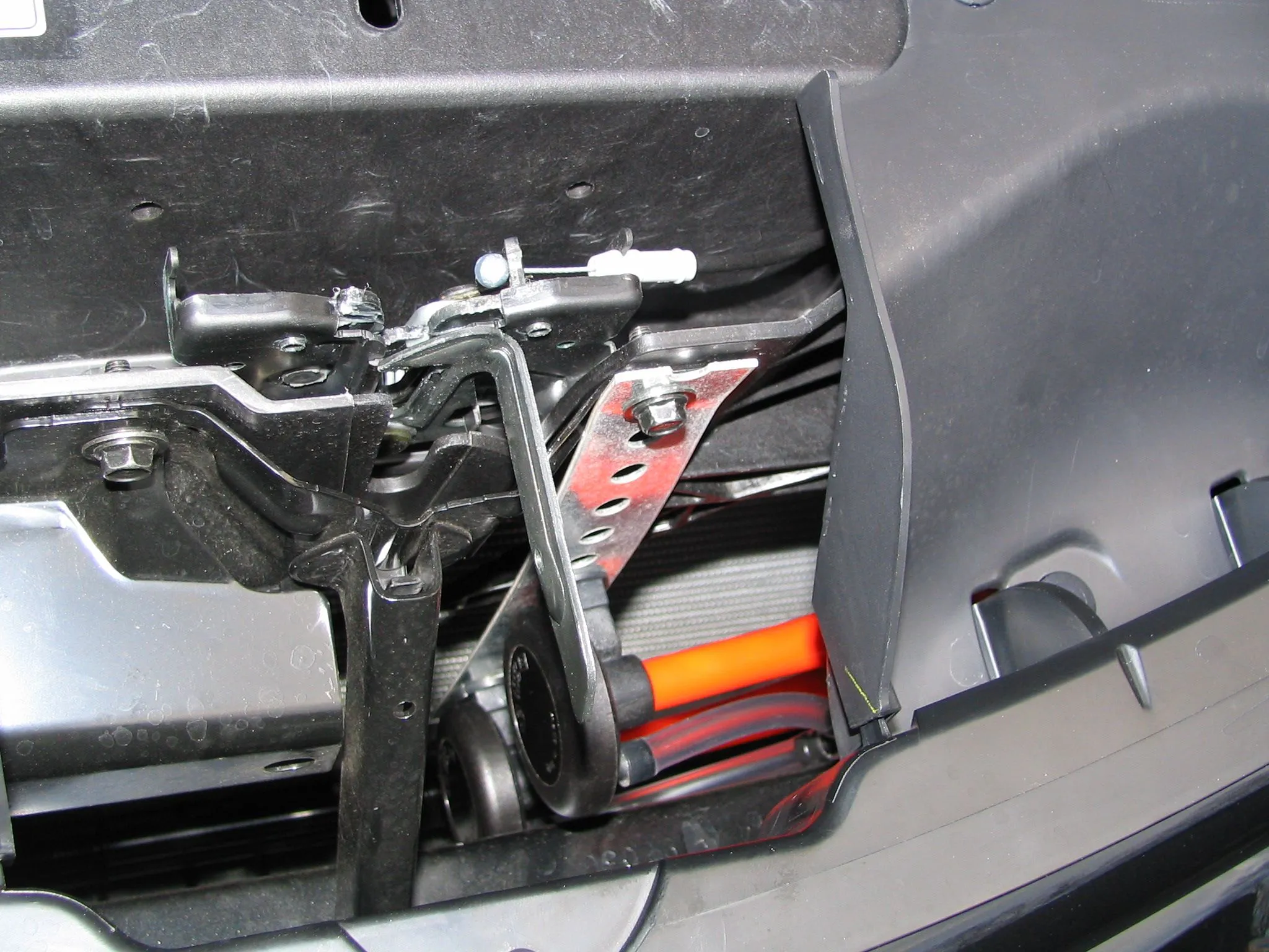

I just finished installing double air horns on the MS3. As posted by many before the stock horn is rather wimpy, much to my surprise I found it to be a Fiamm unit, the outside shell very similar to the Freeway Blaster they sell. I installed a Wolo unit from PepBoys, made in Italy, very similar to the same one on my Miata made by Hella, problably the same unit imo. I attached the compressor and ground wire to the original horn bracket, extended the positive wire to the positive terminal on the compressor and mounted the horns in front of radiator, using a metal strap anchored to one of the screws that hold the hood release mechanism. To confirm what has been posted before: the horn is located right behind the driver's fog light, you need to move the spash shield(3 screws), and remove one or both IC air flow runners to work in front of the radiator. Easy job to do and now when I hit the horn button distracted drivers will defenitely pay attention.
