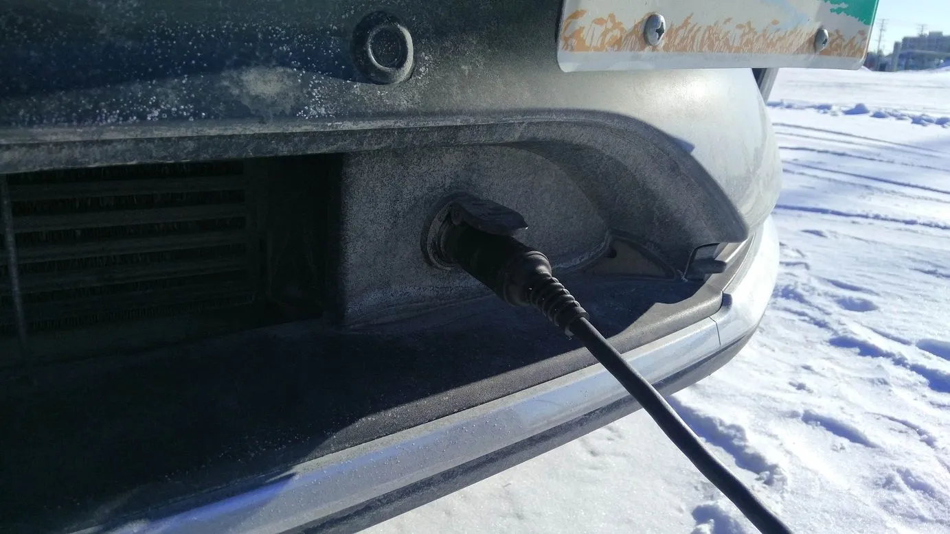

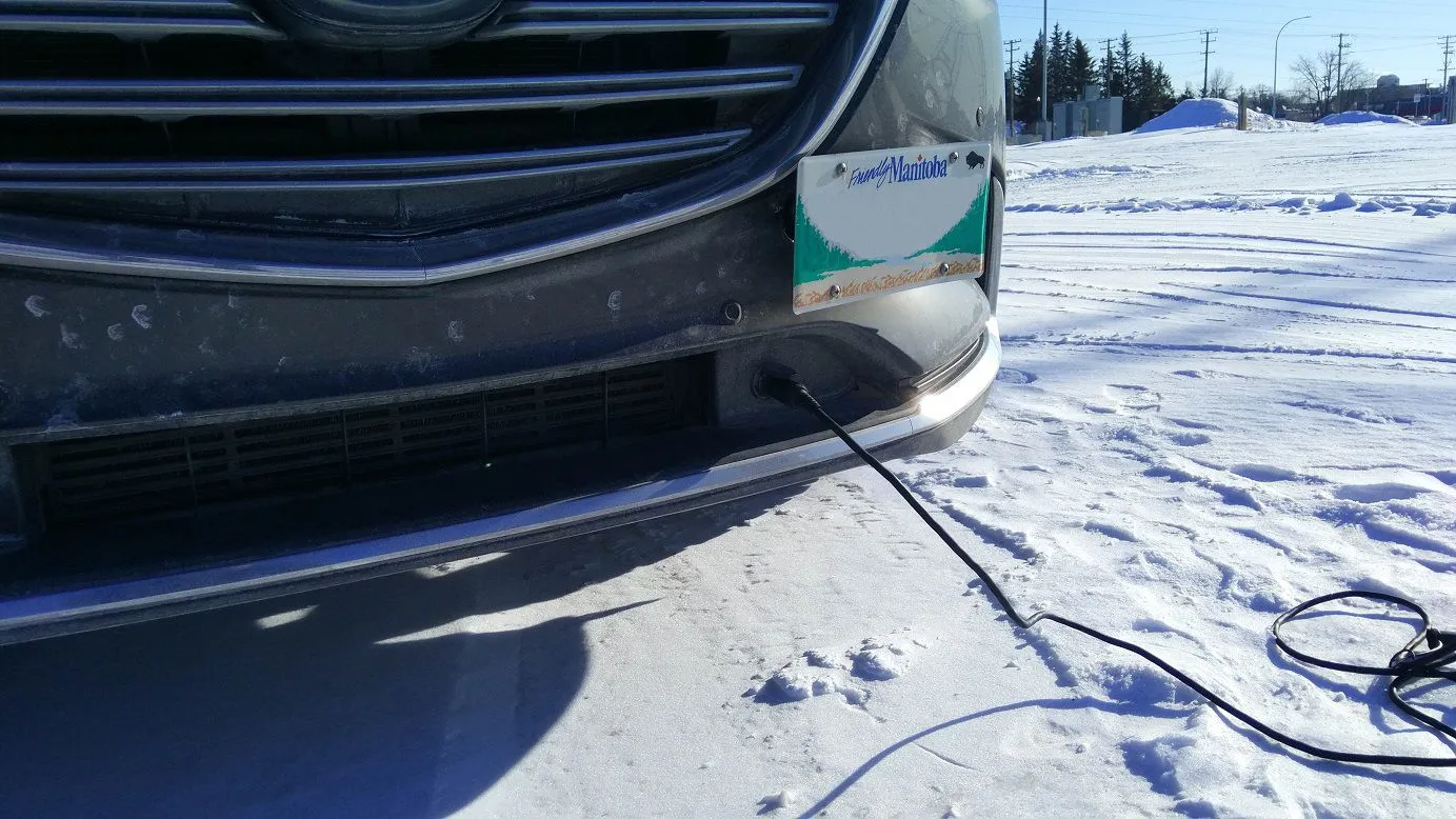

I believe most (all?) Canadian Mazdas come with the block heater already installed (either at port or at the dealership). In these installations, the cord itself is not fixed to the car. It is a separate cord, and one end plugs into a port on the front bumper while the other end goes into the electrical outlet.
I went out in -35c to get these pictures lol

Yep, mine is like that too. If you're asking this question, there's a good chance you lack that cable. I'm guessing you recently bought your '16?
If so, the question then is, where do you get a cable that will fit in there, because it's NOT a standard electrical plug. And that's actually a question I'd like to know the answer to. Someone said Canadian Tire carries them, although I'm not certain of that. I guess the dealership would, but probably for twice the price.

My block heater cord just dangles out the front of the car, driver's side, through the bottom of the front facia. I just plug it in with a heavy duty extension cord.
