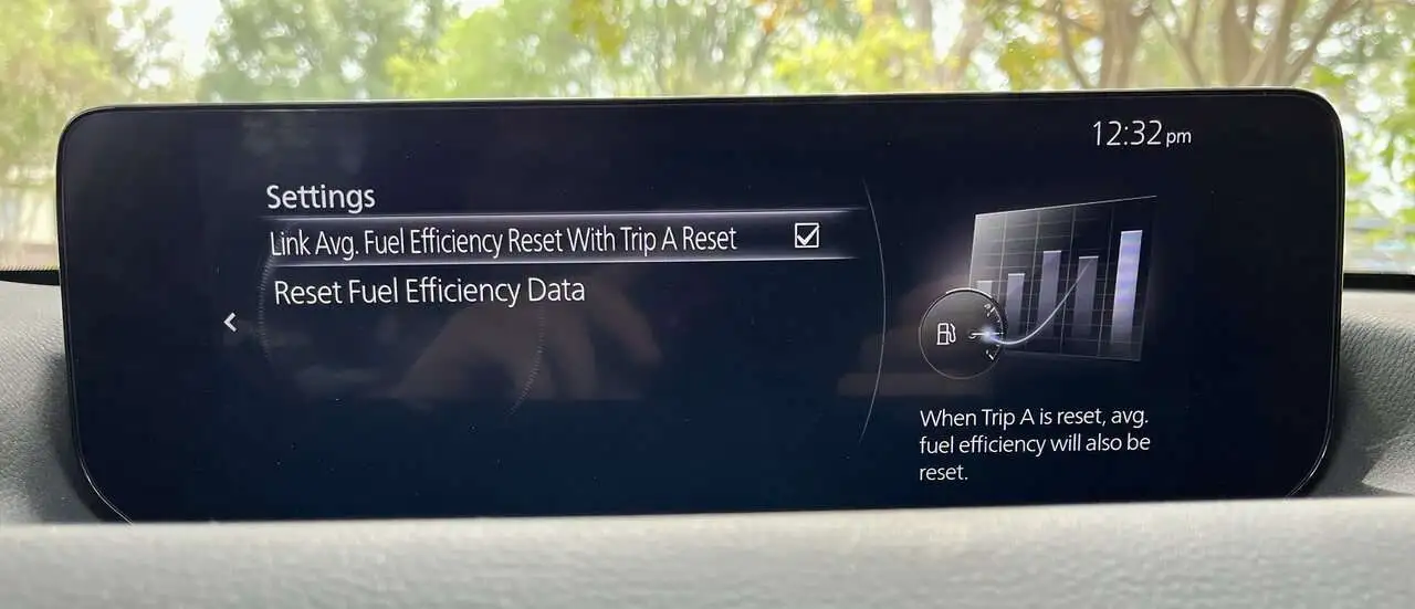

I have 4500 miles on my 2023 S Select and had the oil changed at 4300 Miles.
i discovered something with the Fuel Efficiency History (FEH). My MPG had been around 26 MPG since the car was new. I wondered why there had not been much variation, better or worse.. After the oil change and now that the car is more or less past its break-in period it should have improved. I did not use the trip odometer and calculate the mileage manually dividing the gallons into the miles traveled since last fill up. I relied on the FEH. Apparently this system averages the total miles driven, in my case 4500 miles.
I dug through the display screens and found a setting to reset FEH each time trip odometer is reset. After making this change now my mileage is in the mid 27s MPG.
With engine off and power on, select Information in main menu, select Fuel Efficiency Monitor, hit select again, select Fuel Efficiency Histoy, then select Link Avg Fuel Efficiency Rest with Trip A Reset.
it took my 10-15 minutes originally to drill down and find this. It’s not intuitive.
