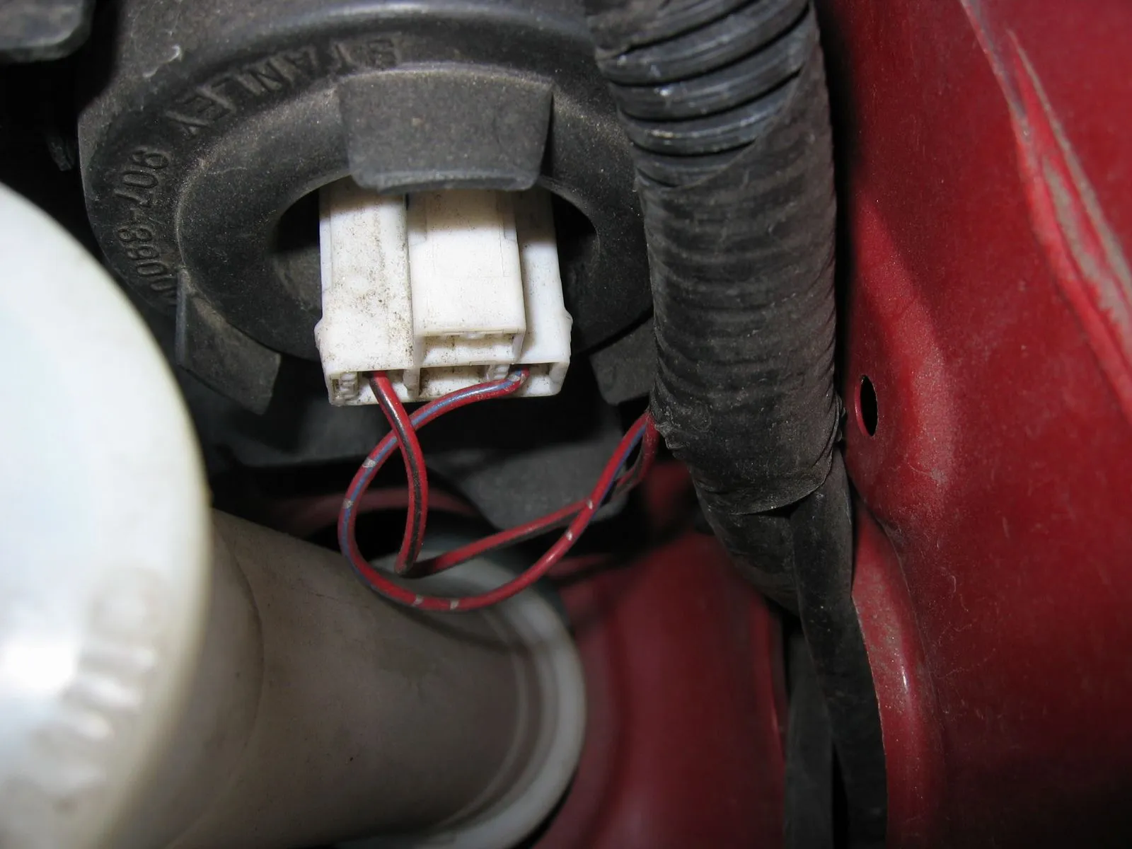

I'm confused. Did you buy the car new? I can't believe Mazda made a mistake and crammed the wrong bulb in there. Sounds like someone rigged this up custom for god knows what reason. I have attached photos of the back of my stock lowbeam headlights--do these look familar?
Hope it helps.

I am the only owner of this car, I bought it in Feb 2002. My assembly looks just like yours but has 3 wires coming out instead of 2, I would have to check and the dealer has my car.
