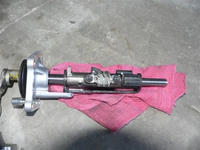

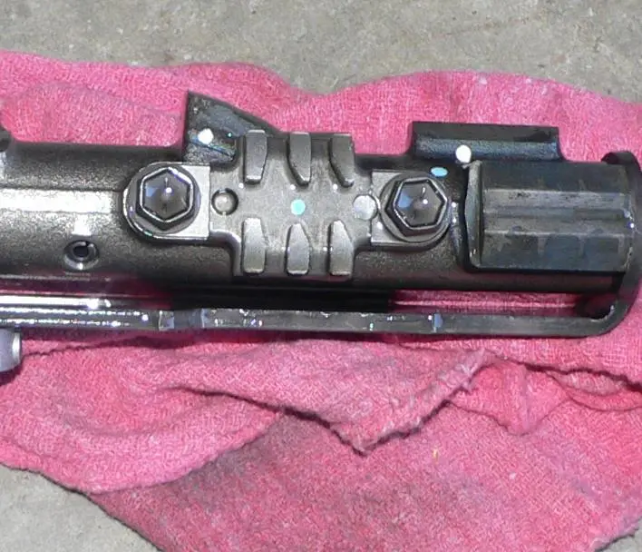

The business part of the shifter gate looks like this.

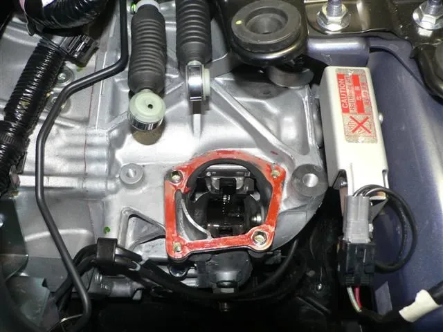

Here's some more pictures. You can see the detent ball in the side of the hole where the shifter goes.
Edit: I think that is the neutral or reverse switch, not the detent.

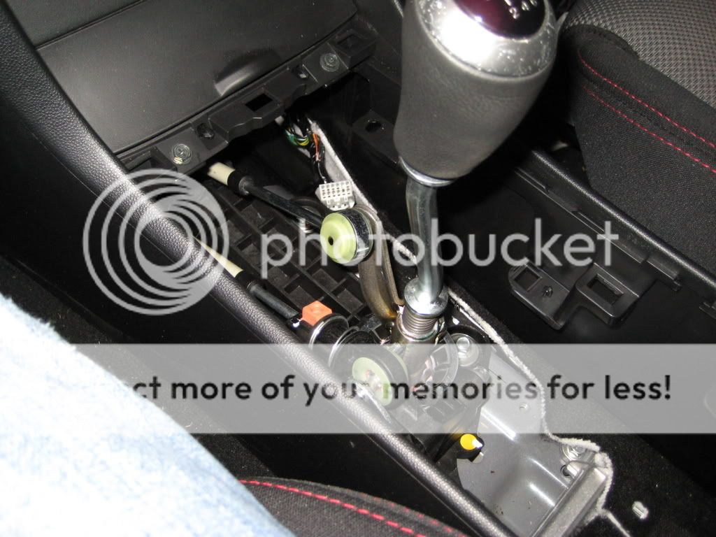

I was trying to answer your question when you definitely dissed me with the automatic bulls***. That struck a nerve because I was double clutching cars with non-synchro 1st gears when you were in diapers. That explains my response and I can certainly put it behind me if you can.
I did not photo document the steps for recurving the shift lever. It is kind of a personal preference thing and I have very long arms. I would not advocate this for anyone who does not feel uncomfortable with the stock shifter.
My problem was with the shifter in 2/4/6 holes, my elbow was uncomfortably rearward. The 5-6 shift also seemed awkward to me because it was so far to the right, away from my body. Add to this the fact that I like to have the 1/2 shift skim my right leg. To address these personal preference issues, I removed the stock shift lever (I recommend the TWM instructions available on their website), carefully clamped it in my vise, taking care not to scratch the spherical bearing, slid a piece of fuel line over the threads for protection, and used a 3' piece of 2" sch40 pipe for leverage. This allowed me to bend the shifter forward and to the left. With the recurved shifter 1st gear is about an inch back from the left side of the console and 6th is about where the stock neutral position is. The shifter is not difficult to recurve with a good secure vise and a piece of pipe.
IF another MS3 driver were to get in my car, he would have trouble finding the gears for a while!
While I am rambling, the thing I really like about the Rotus Linkage mod is that it only affects the fore-aft shift motion. A short shifter means less mechanical advantage in the L-R axis as well and I already do not like the effort required to keep the shifter to the right through the 5-6 shift, it's just unnatural to me. YMMV
