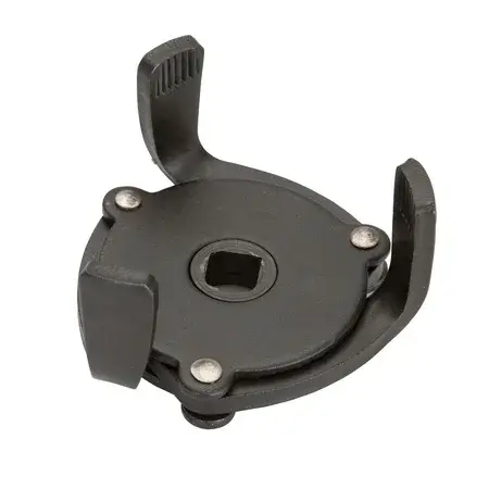

I'm considering getting one of those claw-type wrench adapters if it makes the job easier.
I hand tighten mine every time, but you best believe I have to bust this bad boy out to loosen it. I usually put a shop rag on this when I grasp the oil filter cup. Makes loosening it a breeze.
If you don't want to buy one of those clampy tools above, a rubber glove should do for you, as they're only supposed to be hand-tight. Might need to clean grease off, or simply wrap some low-grit sandpaper on it for grip.

I use a pair of oil filter pliers to loosen the filter. It just takes less effort with pliers.
Aside from the pliers, you'll want a basic socket and ratchet set to remove and tighten the drain plug. 3/8" drive is a good all-around size. A flathead screwdriver and Philips head screwdriver may be needed to remove any underbody panels blocking access to the filter and drain plug. A hydraulic jack and a pair of jackstands to raise the front end of the car (or a pair of ramps). A drain pan to catch the oil - I personally use a plastic drain pan that doubles as a container. A plastic funnel for filling the oil. Shop towels/rags for cleanups and for wiping the dipstick to check your oil level. Oh, and a pat on the back for doing it yourself (y)
