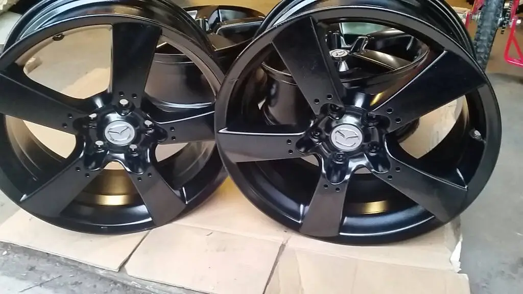

Anyone have the rx8 wheels on the P5?
I just bought a set of them but don't know what tire should it fit perfect without rubbing.
215 35 18
215 40 18

Oh ok But it's not going to have a big gap between the fender and tire?

Are you stock suspension, or are you lowered? 215/35-18 is a near perfect match to the OEM 195/50-16 size.
Yea I have stock suspension I have the OEM 195/50/ 16 tire size that's why my concern is that if I have to lower the car a little bit.
Sent from my SAMSUNG-SM-G870A using Tapatalk
The diameter will be the same with the 215/35-18. So the distance to the fenders will be the same as the stock tires.
Thanks alot for the info
appreciate the help.
