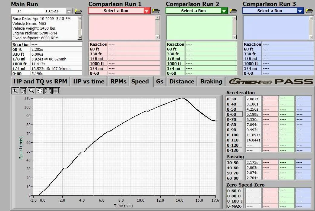

For me the proof is in the pudding. I have a stock BPV. I have stock tires and rims. I do not have aftermarket tubes or turbo inlet. I do not have any ECU mod (no AP, no Standback, etc.), I run the stock CBE, but I am able under good track conditions to run 13.4 quarters at 107, even with crappy 60 ft. times. The car just builds power once you get away from the power hold back of the engine nanny in first and second gear.
A good CAI and catless DP/RP with one step colder plugs is basically all I have. I'm producing these numbers (see chart below from a typical accelerometer run back in April). Note that "up top" the 60-100 mph time interval is more than two whole seconds better than stock. That is huge. It is easily verifiable with a stop watch. And the car is as quiet as stock with no drone.

ETA: Just looked at your graph, I must be dropping power down the track. My 60's are 1.90s, yet I'm only getting mid 14s at 95ish.
