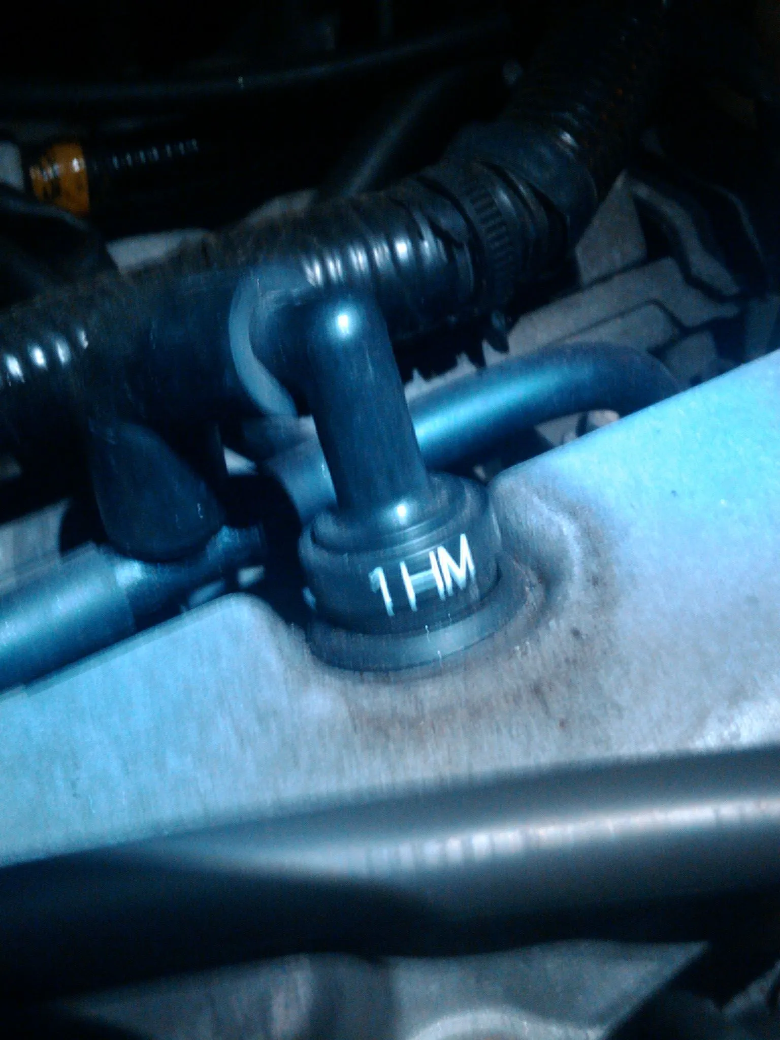

Where is the PCV located at, and what do i need to look for?
I tried to find a pic that I posted to show but the search function is not the best. Its underneath your engine cover sitting in a grommet on the cylinder head cover. A Purolator PV1047 is the one that I use.

Replace your PCV also, the one in your engine could be clogged or leaking. For $3 get a new one and put it in.
Just got home from work. Think I will go and see if I can figure out what the PCV is, also making a belt adjustment.
Update: Think I found the PCV, did not look to be leaking. Snapped a Photo, to make sure I was looking at the right think. I was able to pull up on it, and It just came out. Dunno if that's normal.
