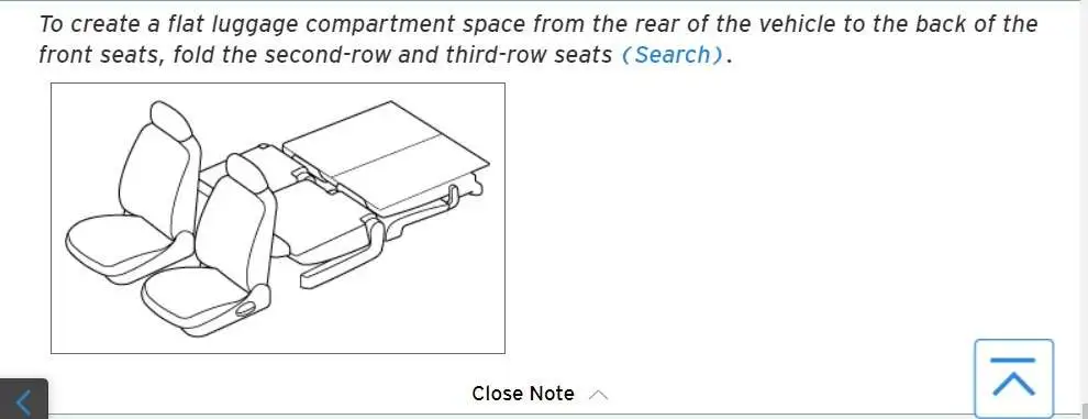

How can I fold down both second and third-row seats so that I have a completely "flattened" cargo floor on my 2021 CX-9 GT? I can get the third row to be completely flat but I can only get the second-row seat-backs to lay on top of their seats. However, they are not completely flat. The manual is confusing in this area as it refers to other sections of the "Book". This manual shows the second-row and third-row seats totally flat as a picture indicates.

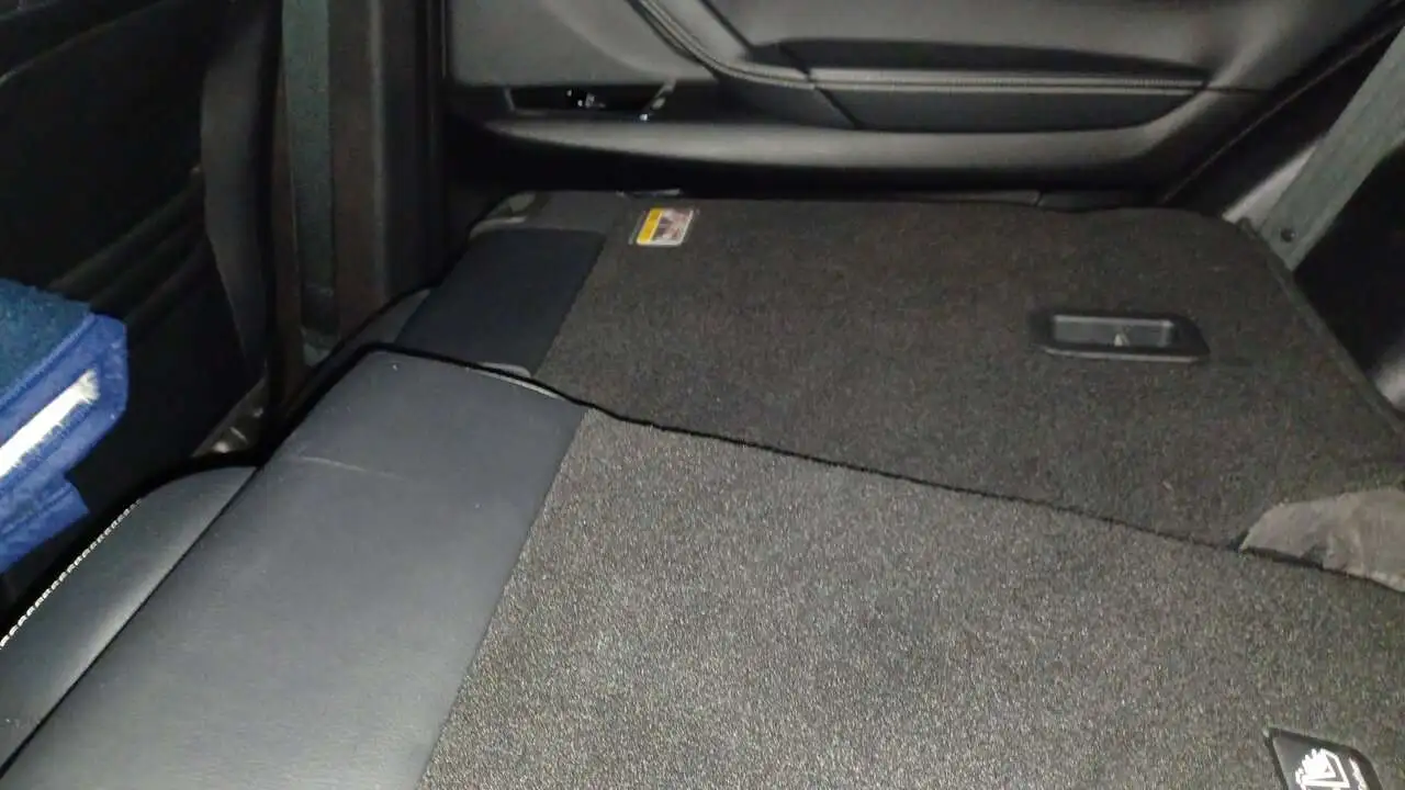

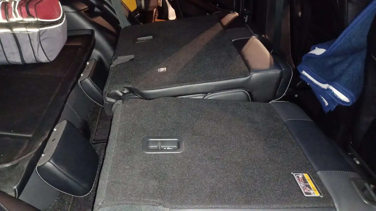

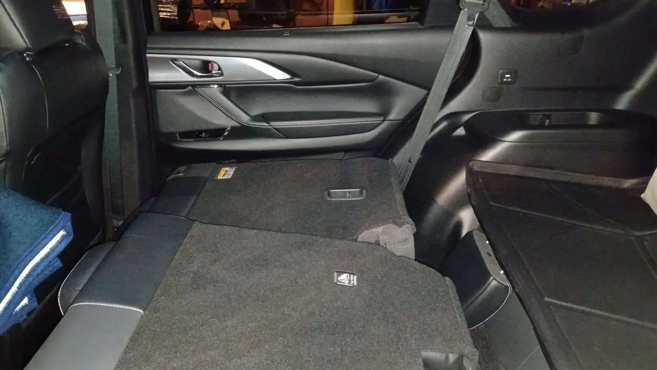

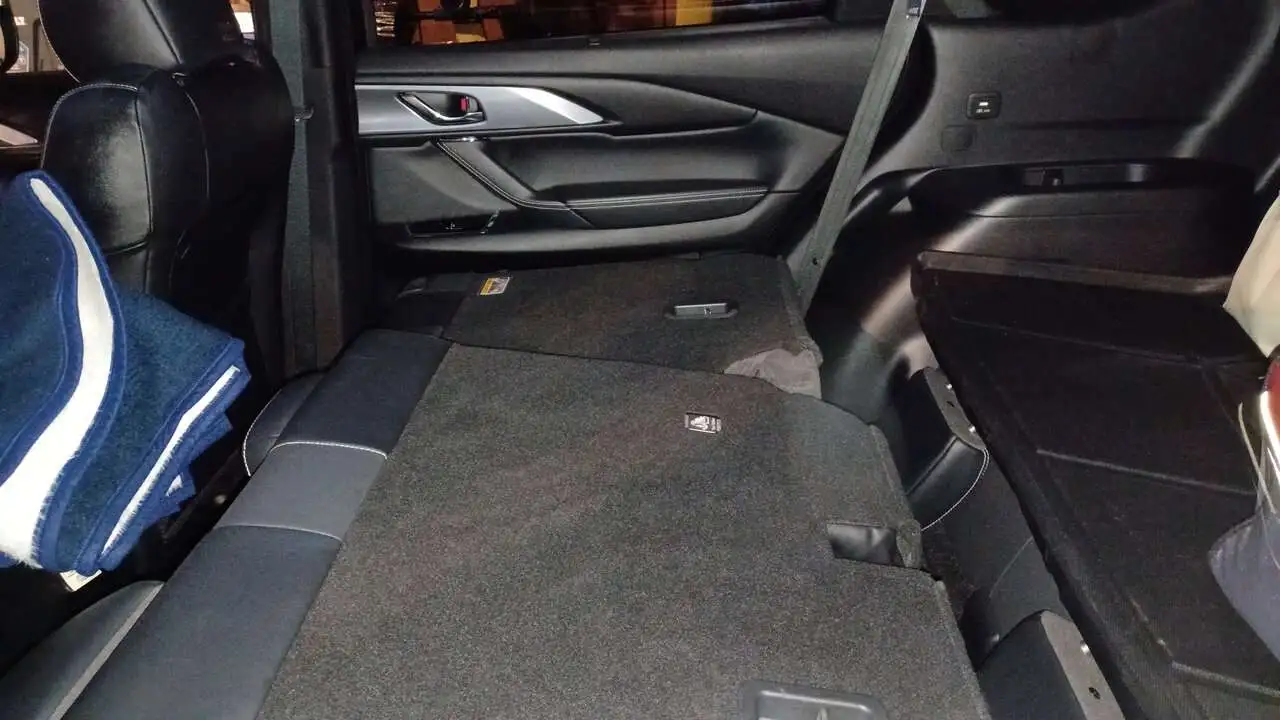

Well, that is what prompted the title of this post. I'm not sure what the manual means by "Flat". Is it the way the picture above illustrates it or not? The research I've done on this through the internet indicates that it is a common question. A good number of posters have asked this very same question and some responders have indicated that it can be totally flattened as the picture indicates and others have said as you have reported, "lays almost perfectly flat". "Almost" is not what the manual shows. Picture on the way.

That is about as low as it goes. The seats don’t go much lower than that.
Although in my 2018 the right and left side are the same height. They are flat from the left side to the right side. They might have changed something between 2018 and 2021. Do you have a powered or a manual second row? The 2018 is manual so that could be the difference.
I don’t know if it is the driver side in your car that is higher than mine or the passenger side which is lower than in mine. (I think the passenger side drops lower on yours)
Was there anything obstructing on the driver side on the 2nd row seat? Like maybe the middle armest if it is not fully stowed?
No the op is 100% correct. I would understand if the 40% right wouldnt go down all the way and match the 60% left but its not symmetrical. I haven't bothered to look in my manual so its my bad but if you apply the same procedure to the right its higher.

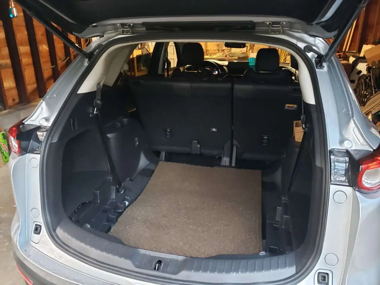

But on a brighter note, I am now the proud owner of a very very rare 2022 CX-9 TWO ROW vehicle!!!!!! Removed that god dam 3rd row from my car, made a cardboard template and will have my new cargo floor fabricated hopefully this weekend. 3 bolts and a wiring connector. The ass cushion was a pita until i figured it out. But otherwise simple as pie. Almost as big as a Rav4 ! Haha

Nope, tried this many times. Tucked the seat belt in, in many ways, armrest was checked each attempt. The damn 60% driver-side seat simply will not lay flat. Not only that but you'd think that there would be no gap between the second and third-row folded seats. This is not the case. The gap is huge. This means that storing small items between these two rows is pointless. Bad design.

Well, they do fold almost flat: approx 5 degrees still up but both sides in the same way. However you do have two levers - the upper one is to tilt the seat forward to gain access to the 3rd row, the lower one is to fold the seat flat. It works only on the smaller (40%) portion of the bench but once you fold it flat you can still use the upper lever to drop the seat lower therefore you can gain extra a few degrees and make it "super" flat - the seat is now actually angled down. For whatever reason you can not do that with the bigger (60%) portion of the bench. You can fold it flat with the lower lever but the upper level does not do anything and seat stays in the "regular" flat position. Then it looks exactly like in op's pictures.

The reason the right seat can drop more than the left seat is because it has a different sliding mechanism that allows to tilt and slide the seat forward with a child car seat installed. If you use the top handle on the right seat to go to the third row, you will notice it drops and goes forward, but the left seat doesn’t do that. I didn’t know you could do it after the seat are already folded though.
I agree both seat should have it, but they didn’t do it with the left side, maybe the center hump prevented it or something like that.
