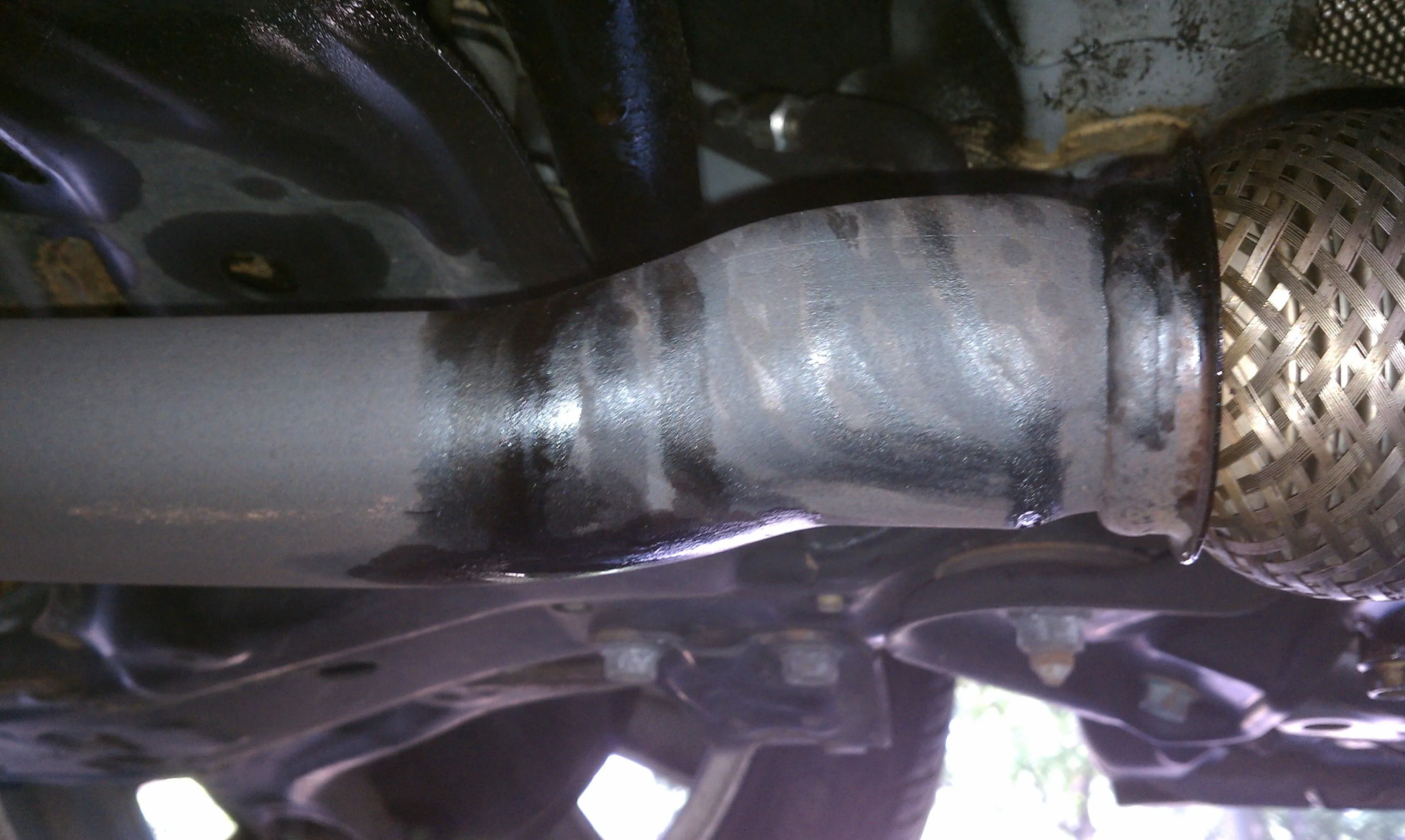

Took a 500 mile round trip in the CX-9 this weekend and noticed a burning smell when I stepped out of my car at my destinations.
Looking under the car, I have some fluid that was dripping directly down every minute or so onto the section of exhaust immediately in front of the mesh portion (cat?) attached to the exhaust. Hits the exhaust, smokes, and then evaporates. Leaves a stain on the pipe.
Any idea what is above that would be leaking? It does not appear to be condensate from the A/C.

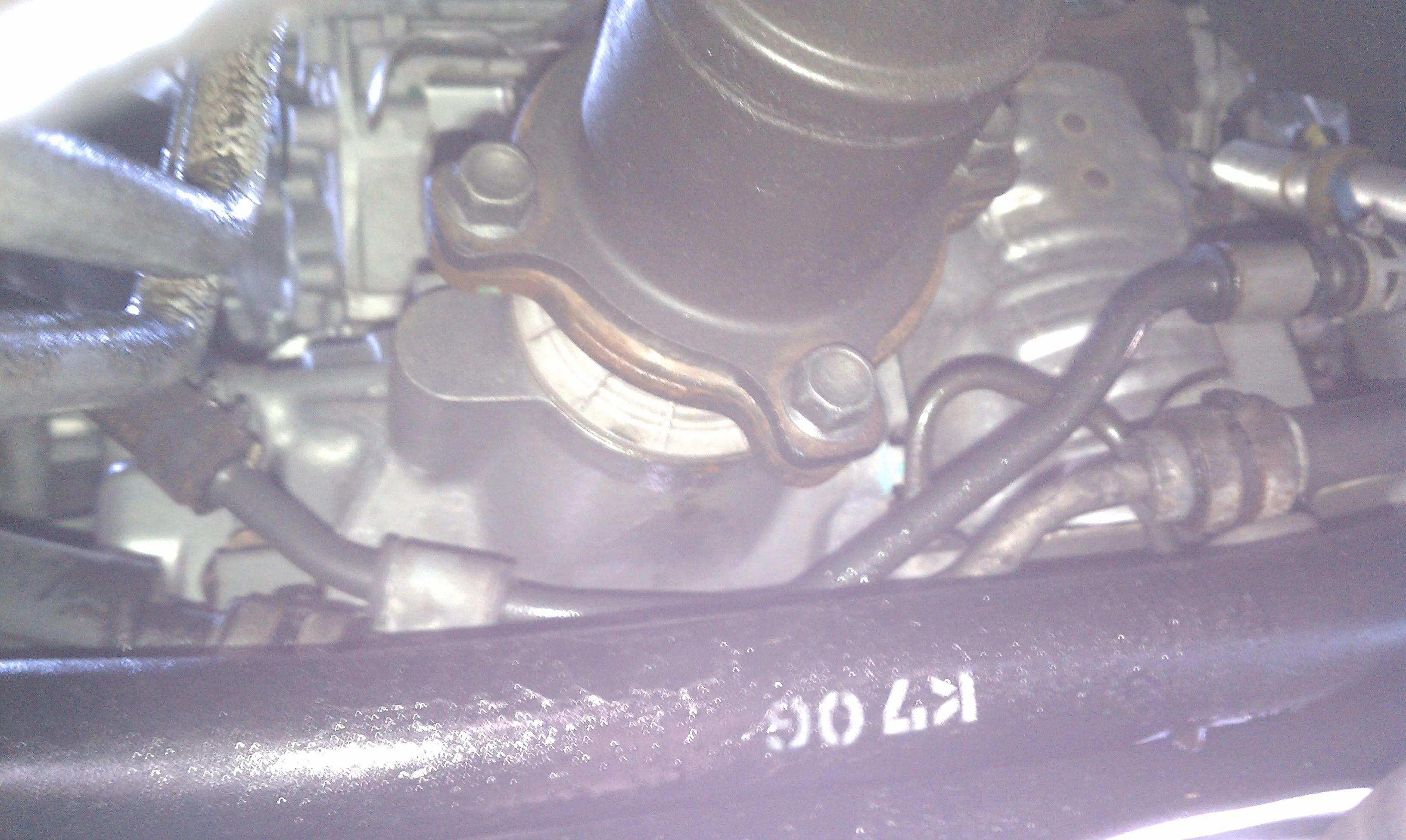

I put the car on ramps and here are some pics. I'm not quite experienced enough to tell where it is coming from. It also looks like it has spattered all over. I hope some will have some thoughts.
The fluid was a light golden yellow and was about the same color of the oil on my motor oil dipstick. However, I'm not sure of the tranny fluid color and I know my brake fluid is also that same color. It felt slippery and then tacky.
Please take a look and share your thoughts on what might be leaking in the center there. If it is tranny, I may be covered by the dealer, as they did some work last year. Otherwise, it's out of pocket. Thank you.

it's probably in the wrong place to be brake fluid. if the brake fluid level is OK, i would rule that out. it's really hard to say based on the pics where it's coming from, typically tranny fluid is pinkish though.
Turns out that it was gear oil according to the dealer leaking from the transfer case. It was replaced. Although there's still a faint smell, I don't see the dripping. We'll see.
