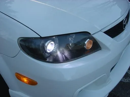

hey whitemp5seattle, did I read that you installed projectors on your P5?
(sssh)
