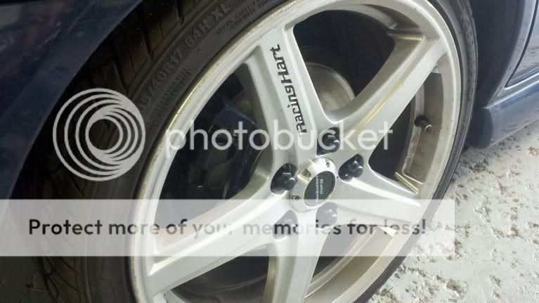

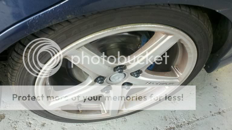

in the how to it says to trim the wiper arm as well. i did it today and now it works great. also after a year and a half i replaced my seized rear calipers with new ones. Black and blue calipers anyone?
