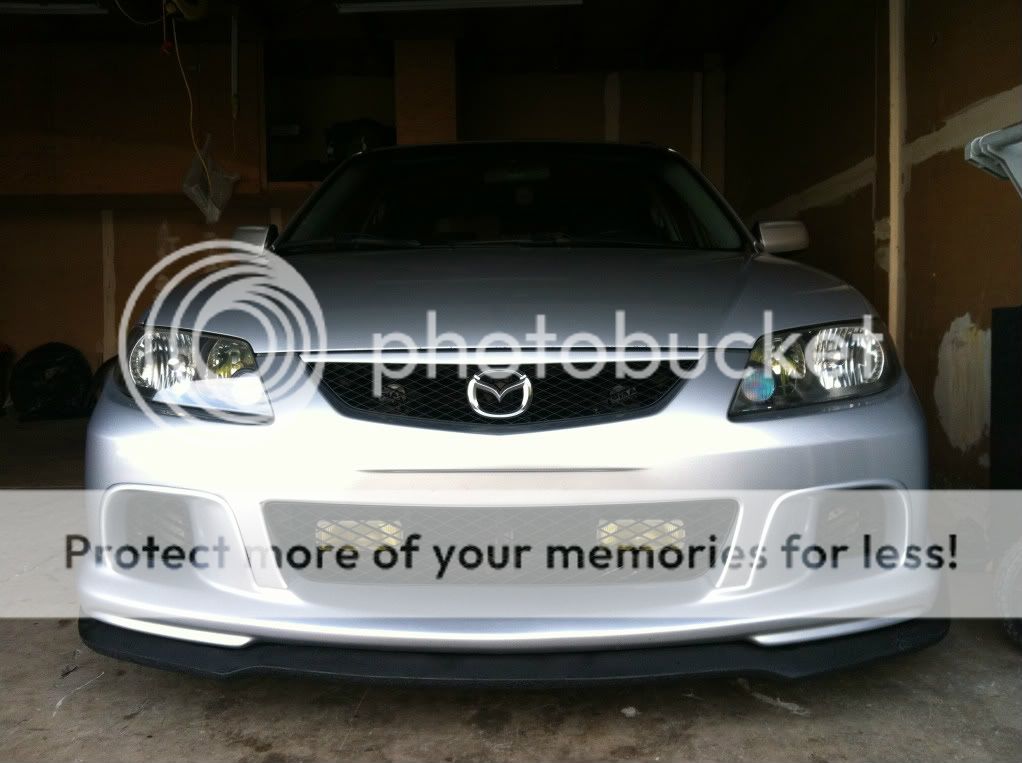

in addition to replacing almost all fog lights and driving lights, I'm installing MSP front sway bar, 626 intake manifold ($40 @ pull-a-part incld ERG), new led tails, aac bumper brackets, patching a hole on rear bumper, awr endlinks f/r, SU front and passen side motor mounts. this is what my car looks like now.

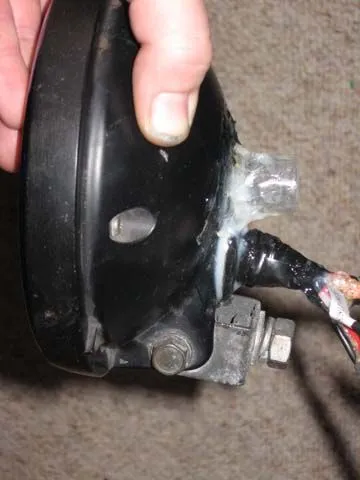

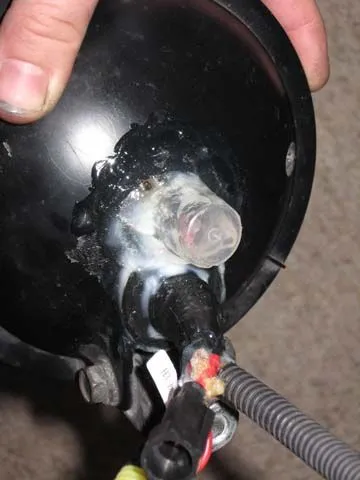

didnt u have to modifiy the fogs to be able to put hids?
yeah. "modified" i pushed up the light cover inside the actual fog light, visually increases light output. i added a spacer in the rear, it needed just a few cm of extra space, my construction isn't the best, but i've had this design for over 4 yrs (150k miles) with no water leaks. i increased the grommet hole in the fog light to fit thru all the wire connections, my HIDs came with a new larger grommet. due to the slightly increased space in the back of the fog light, i cut a clearance space (dremil) in the fog light bracket on the car. if i could only weld, it could look alot cleaner, but from the front it looks professional.
