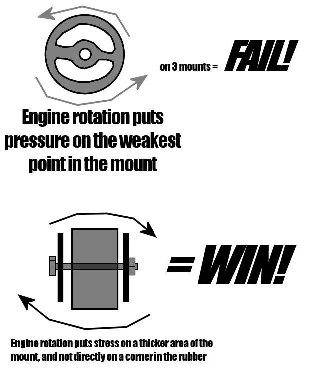

jeg:
lol, I would agree for any of the three other mounts
but for the tranny mount my oppinion is to just leave it alone (actually I don't think anyone makes an insert for it, but thats besides the point)
theres a reason only one company (to my knowledge) makes an upgraded transmission mount: it just doesn't break, it has next to no stress on it in comparison with the other three, and it doesn't suffer the same fundamental wear issue of the others
the reason the other three tear is because they are being rotated inside of themselves....gah it's hard to explain, so heres a picture:
