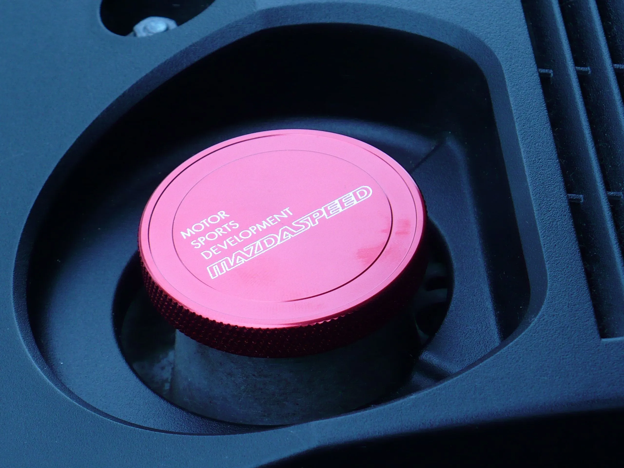

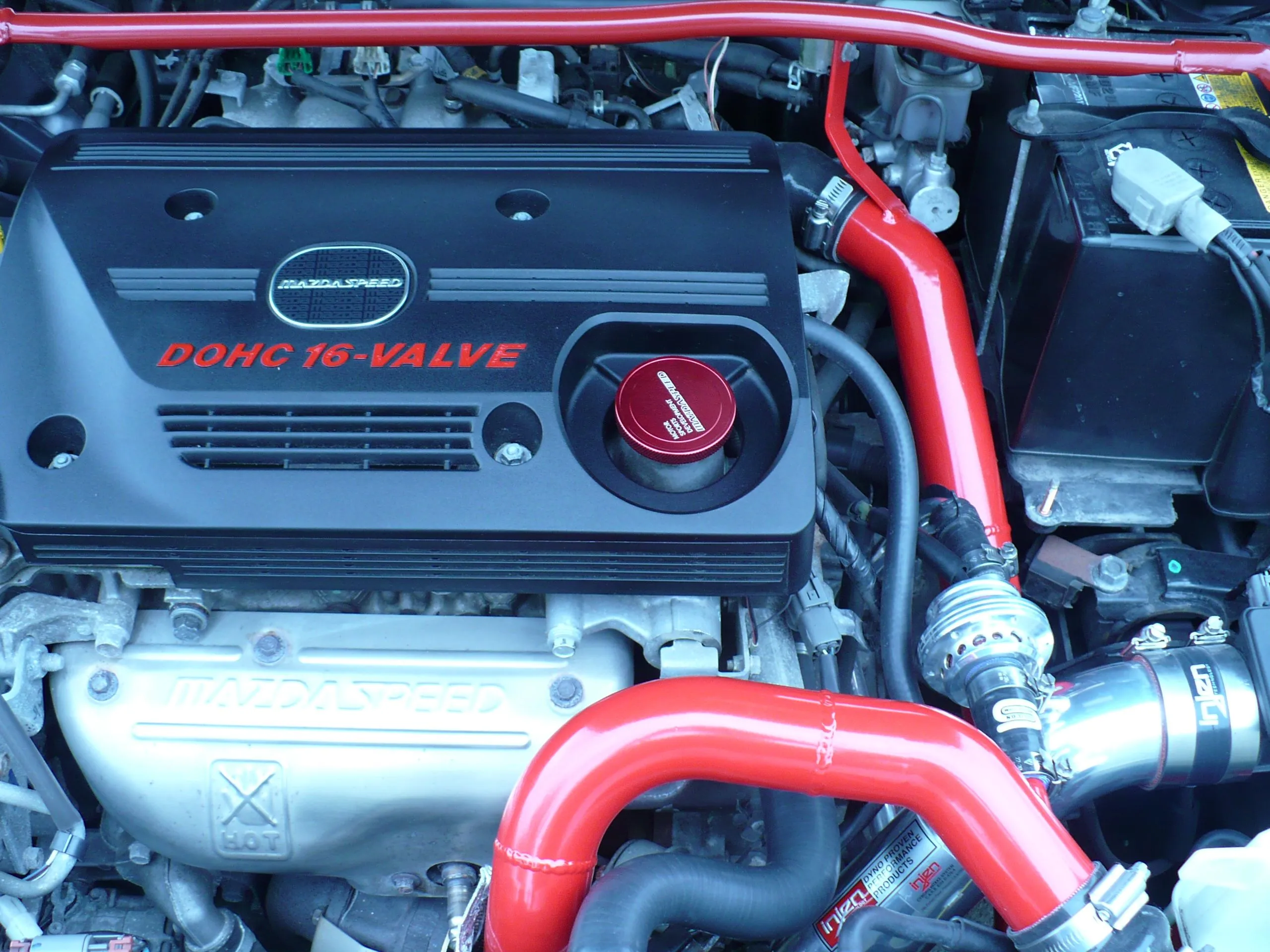

just bought a jdm mazdaspeed oil cap to match the rest of the red under the hood. still waiting on medieval grill cover and dead pedal.

Finished Tig welding my custom FMIC piping now i just need to figure out where to place the nipples and BOV flange at..I made two different upper Coldpipes for relocation of MAF or not relocated and the same for the CAI..and I also need to get them powdercoated SATIN BLACK....
