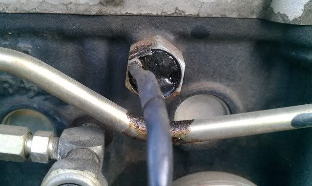

Alright I got the head off and am taking in tonight to a shop, I found where my pretty large oil leak is. The knock sensor seems to be leaking oil, and lots of it. Doesn't really make sense and it must be coming from the head but it really looks like it's coming straight out of the knock sensor. Should I remove it and re-seal it? I thought it required a thread seal on it, any insight? Also the pistons have a lot of crud and buildup on them, must be due to the HG.
buildup is typical. it happens. they are after all, under explosions. the knock sensor DOES require thread seal of some kind.
you mean this sensor? i was curious cause both of my motors had this......
that's a knock sensor yes.
well when the first hg blew at 205 k miles my knock sensor was blown out and this motor has 115k and its seeping a little. anyone know the cause?
Exactly, mine is leaking like that too. It's like $150 so I hope there is a way to fix the leak. There is oil EVERYWHERE underneath that sensor, I know it's been leaking since I got the car at 86k miles.
Would teflon tape work, what should i use to reseal or do I need a new sensor first?
