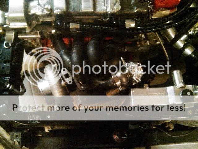

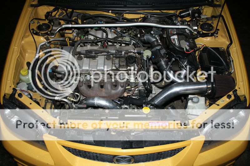

finished my pipe rounting and intake tonight. if i feel like it next weekend, ill take it all down, grind the welds and paint the pipes. though. im not liking the sound of blow off valve + blow back or whatever through my reactive filter. wonder if i a foam filter will be any quieter.'
Nice, that looks like a 4" comp inlet. What turbo? I hit 300 on my old school garrett last summer but my stock im was holding me back. Don't you have 505's IM too? I think you were the guy bitchin about the welds right .. you must be a fabricator.
Relax relax, i'm sure you fixed it. Looks like a nice turbo setup bro.
yes sir that's me!!! were a pain in the a55 to fix.. and yes i am but i also do this stuff everyday so when ever i can work on my cars i try to.. guess what i get for being lazy to fab something up o well.. i hope it stays together...
That turbo has a 4" inlet with anti surge t3 .63 back i believe its a 35r or sc61(cant remember) its center and front section is garret back is precision. that a customer of mine left on the shelf.. with no desire to fix it.. it sucked in a rock. i use it for mock up purpose's..
I just ordered before a 6765 precision billet wheel .82 DBB for the msp that will be turbo i will be using in this car.. car is set up with boost by gear.. hope fully tranny last for a little while.. has the std upgrades..
