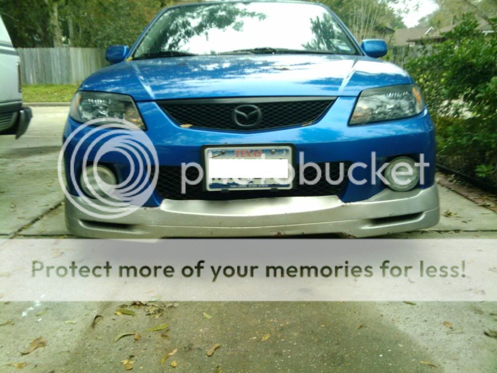

Haven't been able to wash the MP3 due to a lot of rain, but was able to slide the DG Lip on and take a fast picture with my phone. Now just need to get the lip out to paint. I know it looks bad right now but I'll fix it up real nice and get it painted blue
nice I wish I could get one but my driveway will claim it and there is no way around it.
Save you and me both. i thought about a plate of steel would do the trick. (just like they cover holes up in the road) Screw that ditch.
