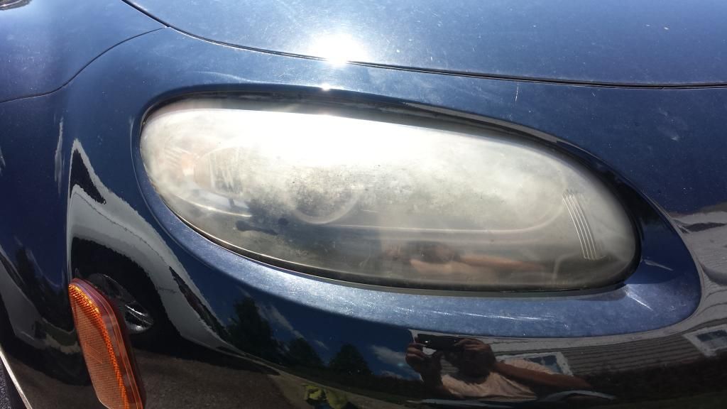

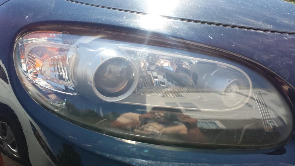

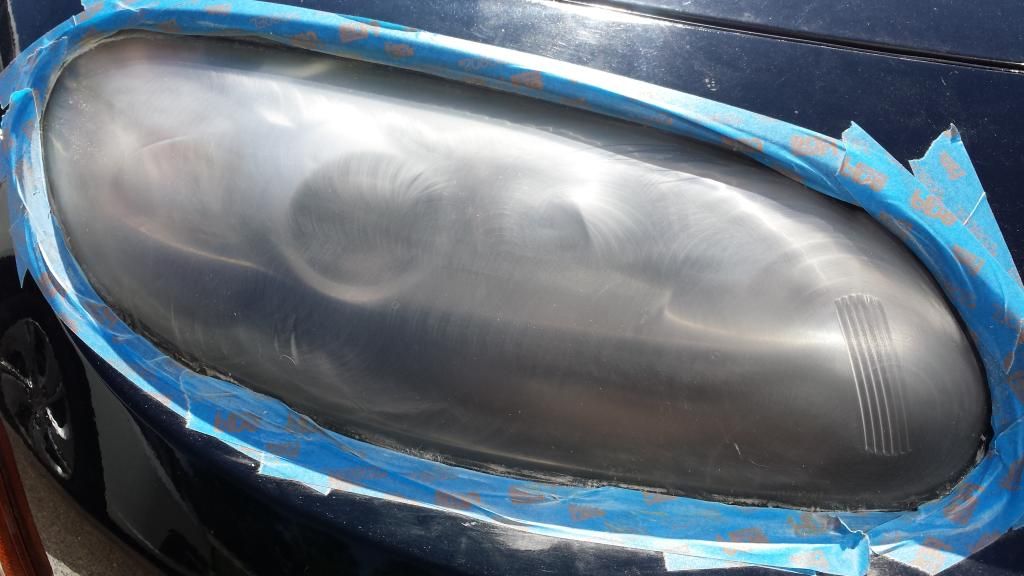

Wife took the 5 today, so I took the time to clean her nasty headlamps on her Miata.
those look like NC headlights. Very surprised they are so cloudy already!? You should try aluminum wheel polish. Does the same for cheap ;) also great for cleaning foggy vert windows and stained pots and pans. Reuse any orbital buffer to make the job easier :p The UV treatment is a valid concern but it is a cheap quarterly job.
