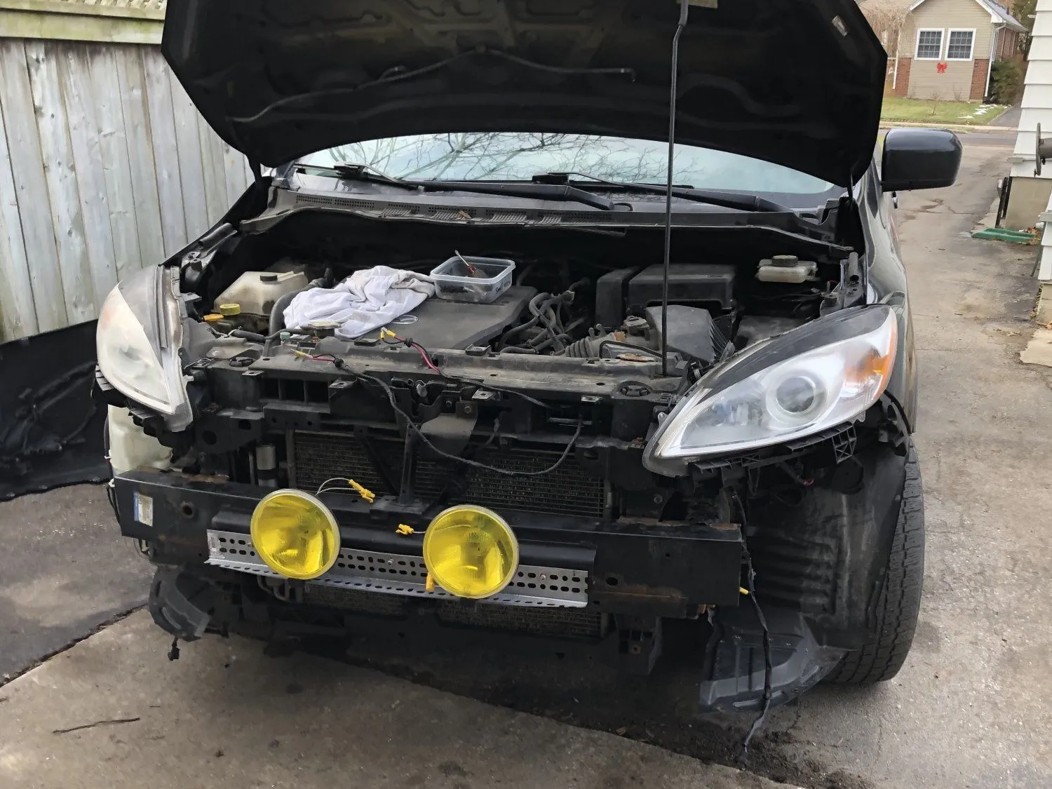

The front end of our 5 has gotten a lot of attention as of late. Swapped out the stock halogen low beams with HIDs, installed a pair of Hella 500 driving lights with retrofitted HIDs, and finally replaced the stock horn with a dual horn setup (Fiamm Freeway Blaster high and low tones).
Reminds of of a stealth install from a guy on one of the old Mazda 3 forums. He installed Hella black out driving lamps behind the lower grille. The grille didn’t really impinge on the light they put out, and when they were off they looked black.

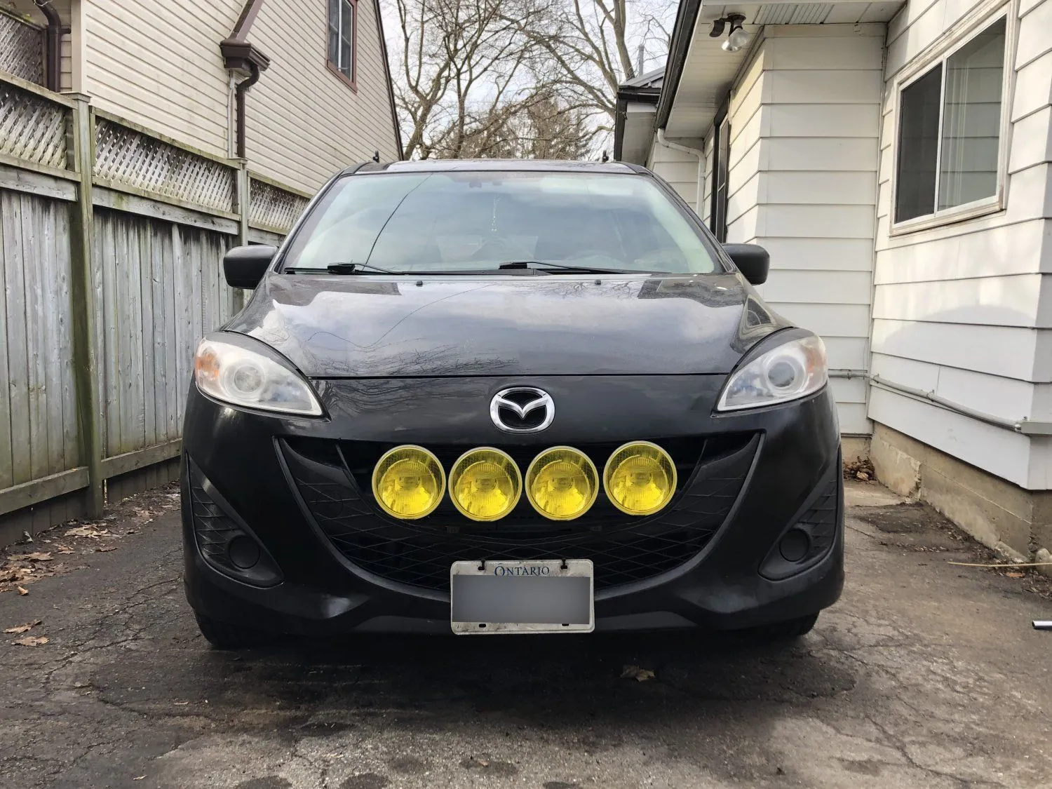

Yeah, I remember coming across that when I was researching fog/driving lights. Unfortunately, there's not a lot of grille mesh or even room between the grille and impact bar to mount these lights stealthily. But I always liked the look of exposed lights (because rally car!). I'm actually contemplating adding a second set to the front to have four lights filling up the section of grill I cut out... kind like this:
