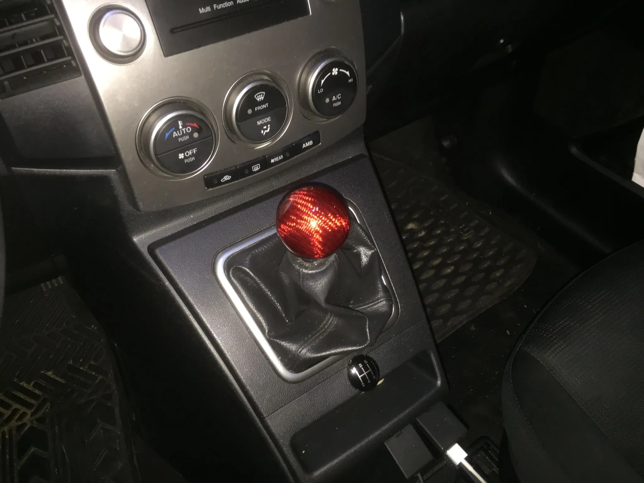

Today a shift knob I had ordered arrived, so I installed it. Red carbon fiber over aluminum. Nice weight and I prefer a ball shape as opposed to the factory design.
I removed the shift pattern disk off the factory knob, a little double stick tape to attach it to the console.

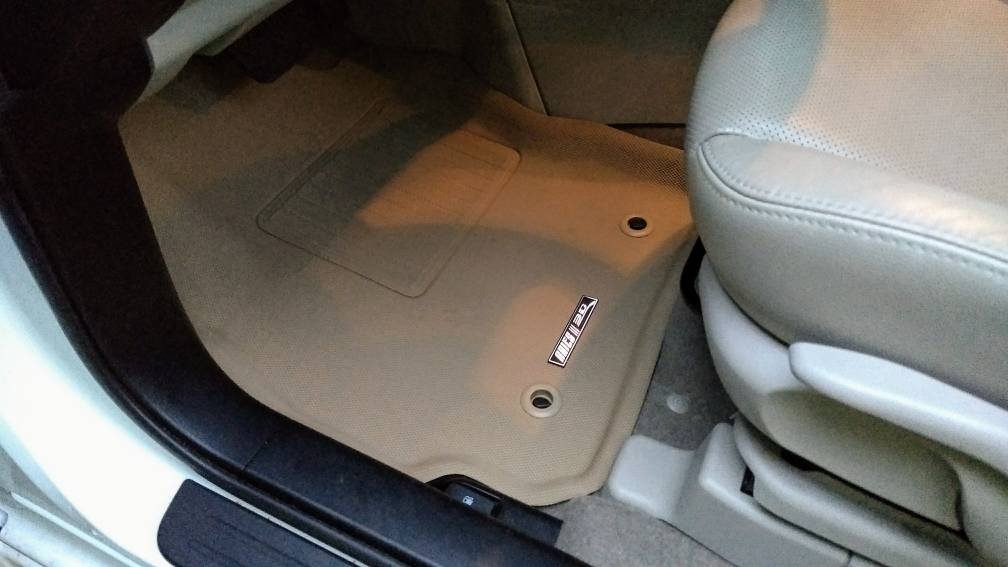

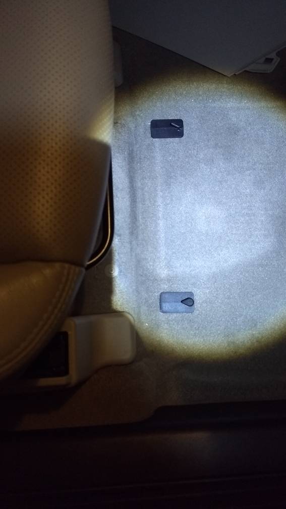

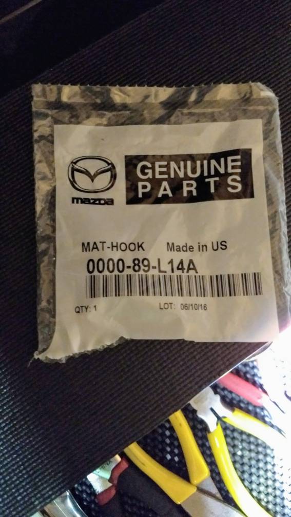

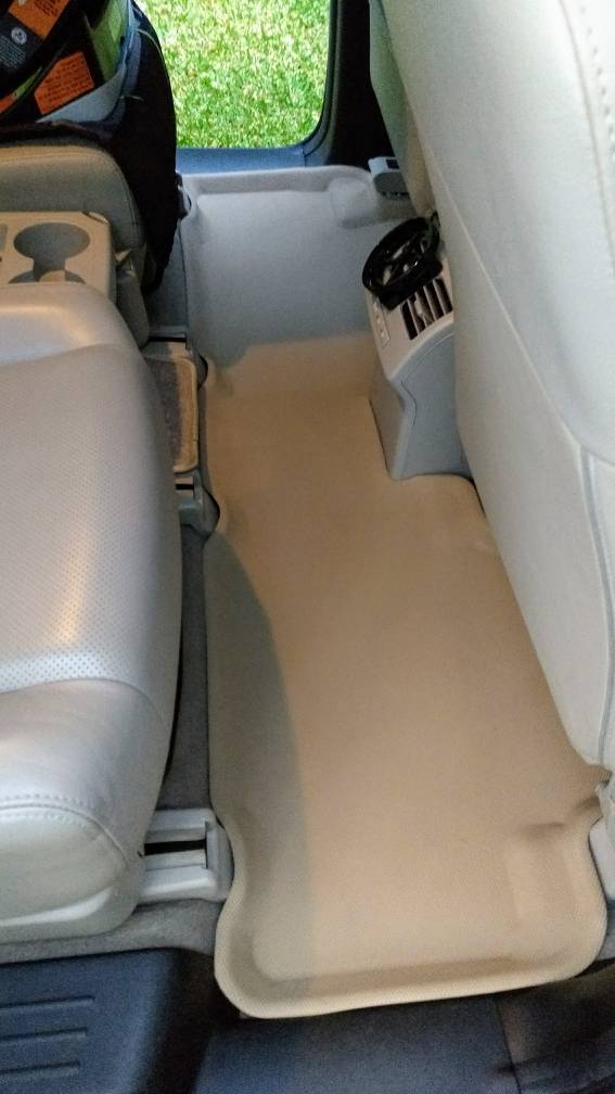

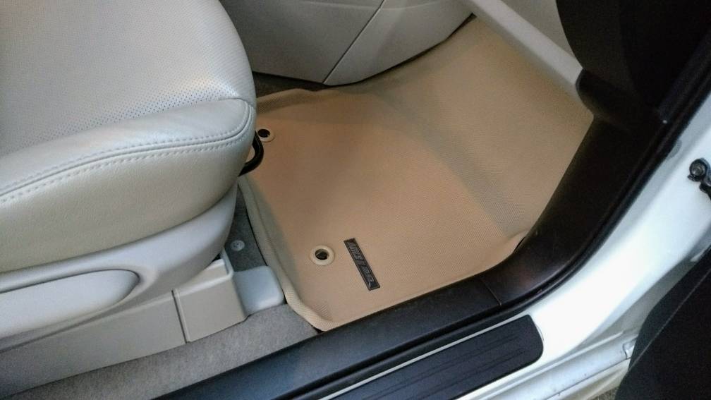

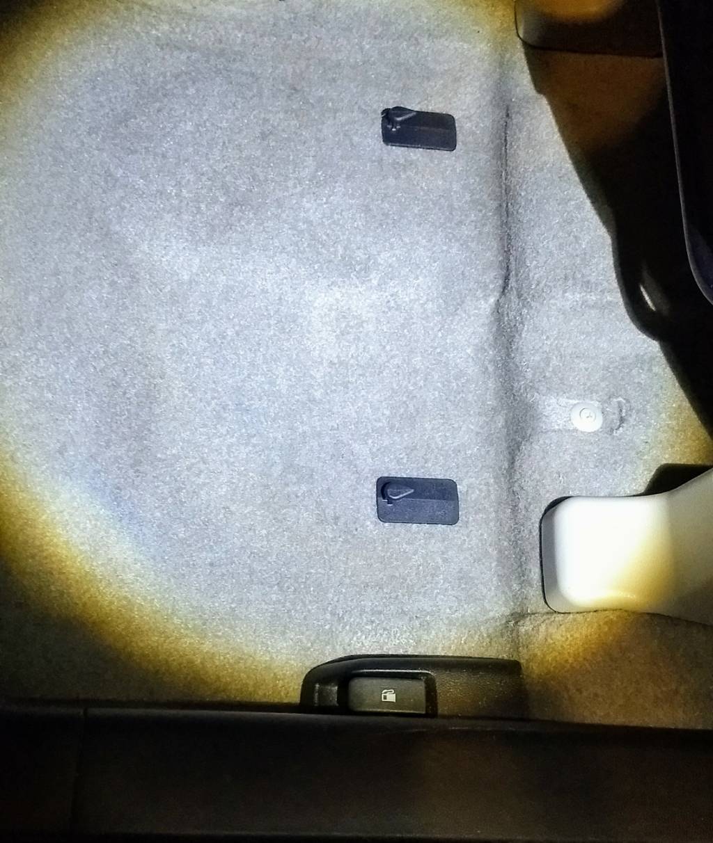

Installed 2nd gen mat hooks in our 2010 MZ5 so that we could use these 3D Maxpider Liners.
