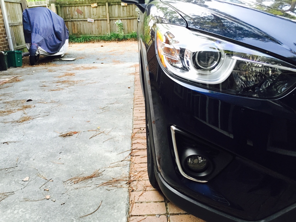

Which are those chrome trims, around the fogs?
Thanks Tibimakai! Those chrome trims are my little twist on the aftermarket triangular chrome fog trims sold on the Internet and found all around this forum.
I found the chrome triangle was a little too much for me, so I customized it by taping it off and blackening the areas off with black (non permanent) plastidip. It's a little more unique to me but adds just a little more pop to the somewhat dull front end. It matches the chrome trim of the grill, too🖖🏽

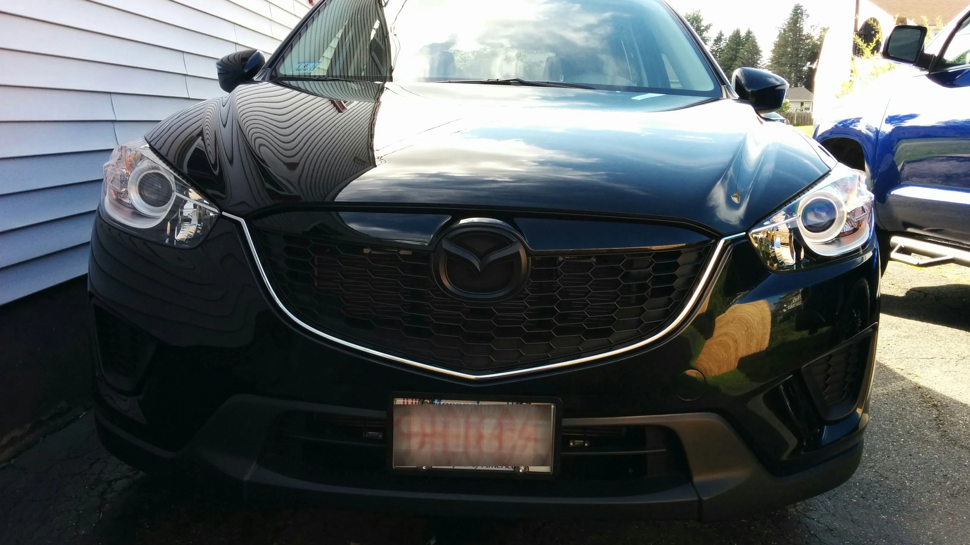

That is what I would like to do with mine as well, except I would like to leave the chrome on the top horizontal edge as well.
Dang I could have sent you my old tires when I bought new ones so you can mount those fabled wheels you have.
If you were talking about the chrome fog trims, that's the cool thing about painting it. You can try different configurations. That's why I chose plastidip, so if I didn't like the vertical chrome, I could rip it off and try something else. If you do it, post some pics, I'd like to see what a "C" or upside down "L" chrome strip will look like.

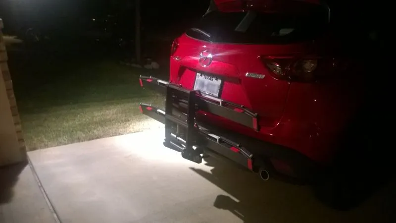

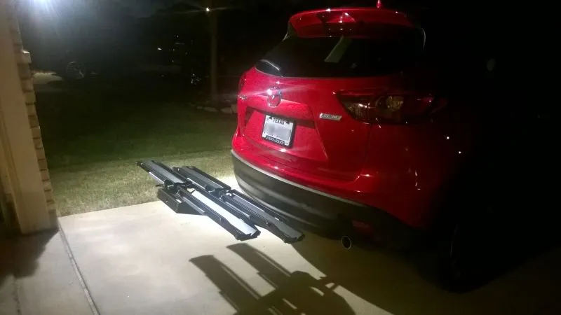

Not today, but over the weekend, ordered hitch and bike rack for the CX-5. Getting the hitch installed on Saturday.

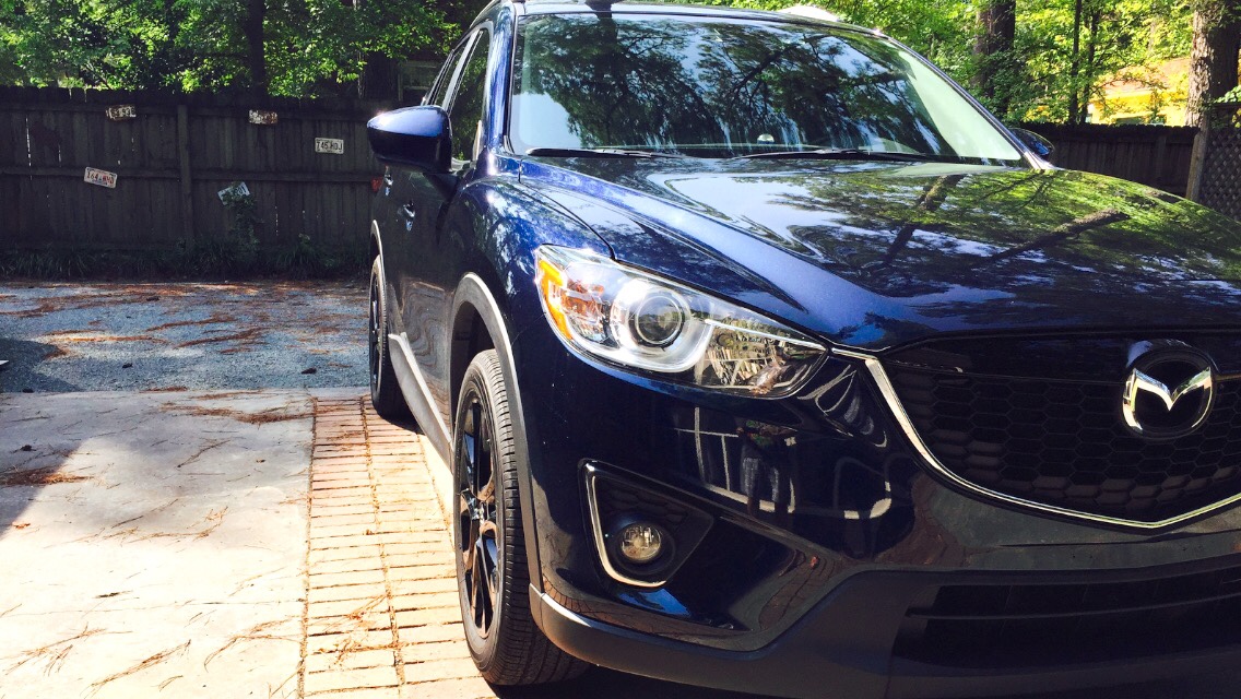

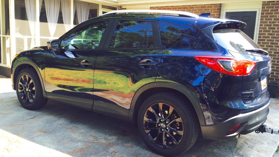

I received my (2) 20mm aluminum front, and (2) 25mm spacers for the rear. They are the type has it's own studs built in. It may be hard to tell from the pics, but it totally changes how the CX-5 stands, and they're very flush to the wheel wells. It's almost like my CX-5 swallowed a... errr, a certain blue pill like in the Fiat 500XL commercial!
I test drove it to about 75mph and it feels no different than stock with no vibrations. Then I retorqued the lugs to specs. Shout out to Mondo for his thread and suggestion!

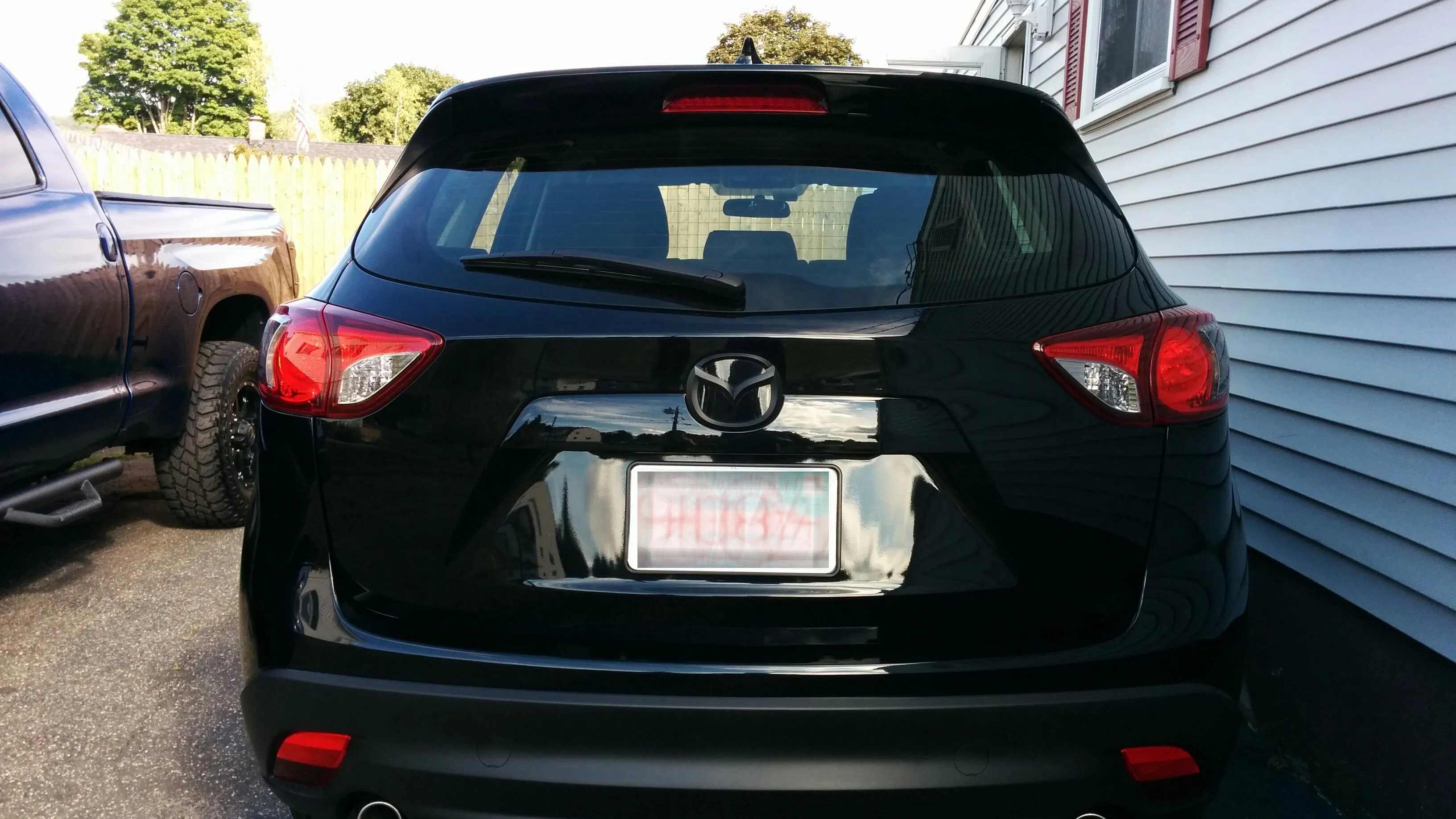

First mods complete .. Blacked out Mazda badges, debadged the rest of the rear gate.
