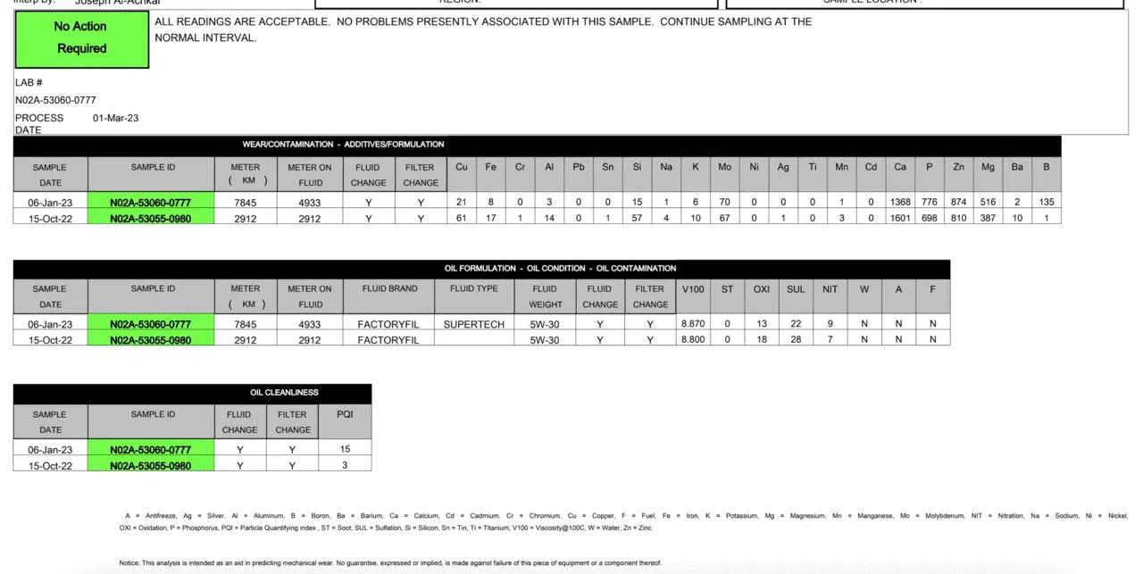

Also to note, if any Canadian owners ever send oil samples for analysis, I've had good luck with Toromont/Cat dealers. Used to send to Blackstone Labs, but CanadaPost always gives a hard time sending, and turnaround is so long. Toromont/Cat turn around is a few days, and they take care of the shipping + much cheaper.

Good to know! I have a CAT shop near my office, maybe I'll look into them for future UoAs.

$29 per sample, and they send to lab in Montreal. You don't get the nice personalized blurb like Blackstone, but almost half the cost after you factor in shipping/exchange rate, etc. I dropped last sample off on a Tuesday, and had results emailed by Friday. Here's a screenshot of my results:
