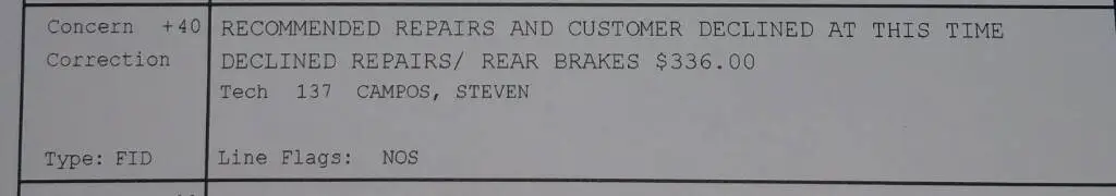

I took my car today to mazda dealer for regular maintainece (like oil change etc). I picked up car later and since i have maintenance package, I paid zero amount. Later today, when I saw a comment on the invoice, which says I declined $336 job for rear break, I called dealer to check what does this mean but no answer. I might have to check on monday again, but just wondering if anyone has any idea ?
Does this mean replacing rear break pads or replacing rear rotors ?
Can anyone help me to understand pleaee. Thanks in advance.
See the attached screenshot of comment from Invoice.

You need to ask your dealer. It's probably replacing the rear brake pads and resurfacing or replacing the rear rotors, but that's just a guess, which is all anyone can offer you. I can tell you that Mazda MSRP for rear pads is $107.08, while each rear rotor has a MSRP of $83.35. You can get equivalent quality parts (and resurfacing services) at almost any auto store and do it yourself to save money - but you need to have proper tools and some basic knowledge of disc brake repair to do the job right.

I spoke to dealer and $336/- estimated charge is for - "Changing rear break pads and resurfacing rotors".
