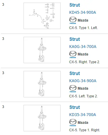

Looks like I will have an experienced buddy's help on this one, so I think OEM makes sense. I noticed there seems to be a Type 1 and Type 2 strut on some of these parts sites. Does anyone know the difference?
Yes Mazda OEM struts and shocks have too many different versions and part numbers for each model year at front and rear which can get very confused. I suggest you visit or call a Mazda dealer giving them the VIN to get correct part numbers.
Also I noticed the MSRP for OEM struts and shocks on my 2016 CX-5 AWD have been gone up twofold! You may consider getting OEM front struts and rear shocks along with your LCAs from Japan once you get correct part numbers from your Mazda dealer.
Called a few parts departments around the area and provided my VIN. They said the Type 1 model numbers for my 2014 AWD 2.5L Touring.
