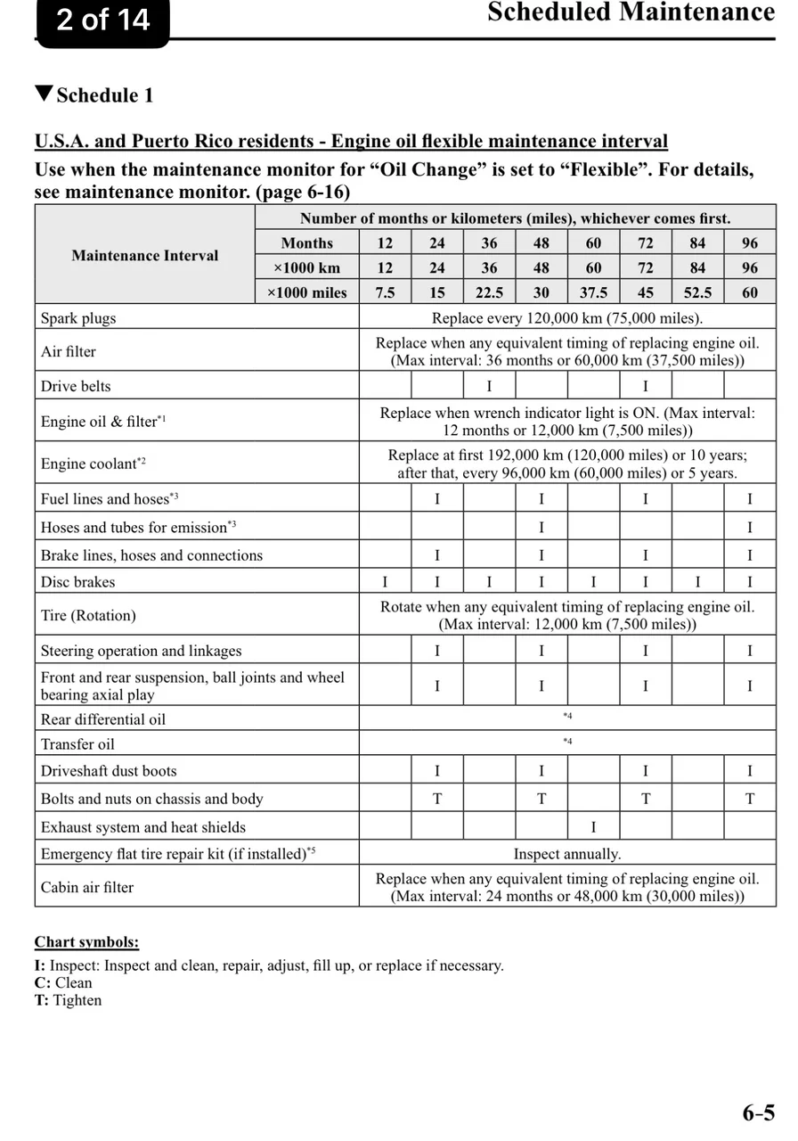

This is the official maintenance from Mazda. Not manu things as you could see.
Definitely worth following the basic maintenance schedule in your owner's manual.
