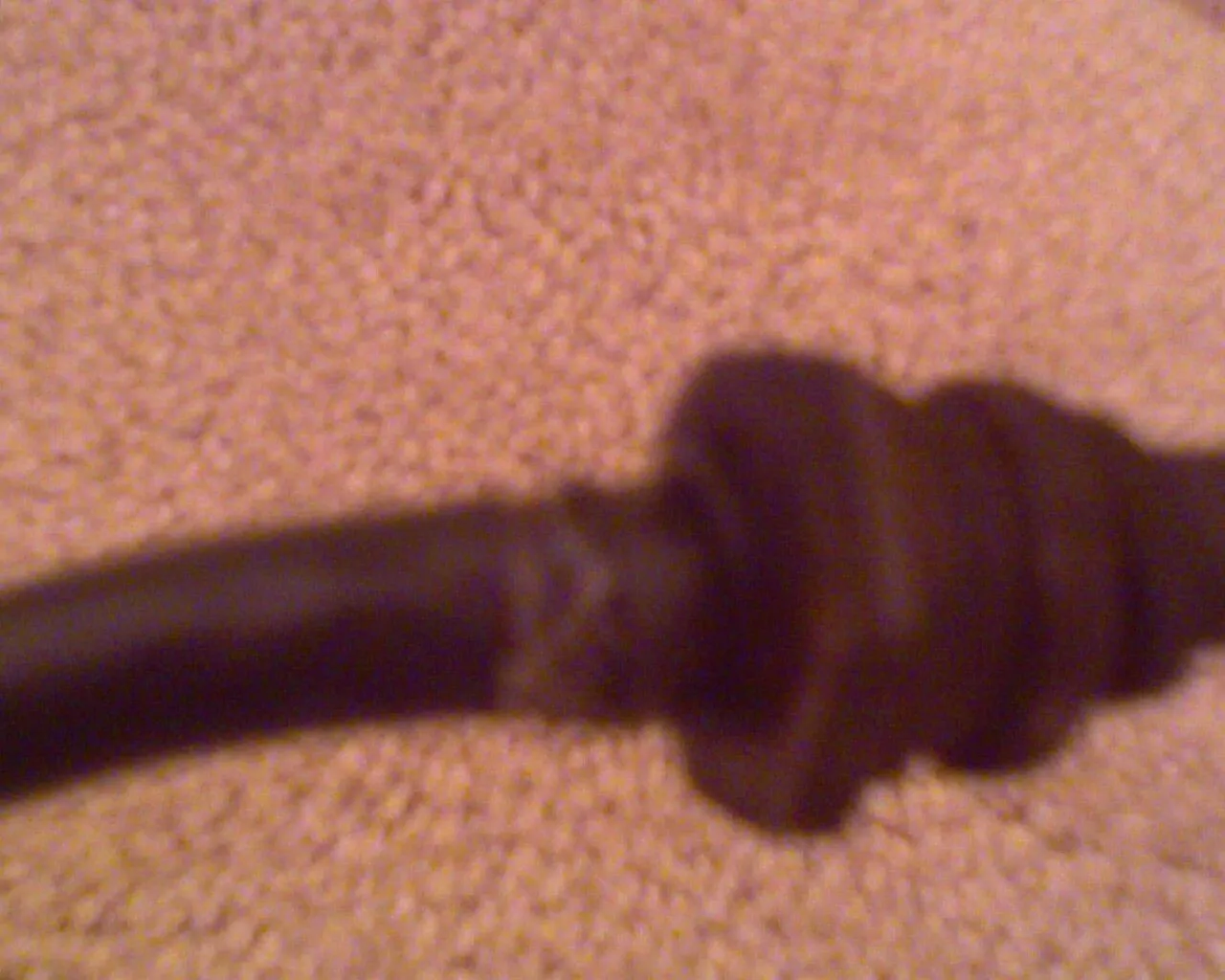

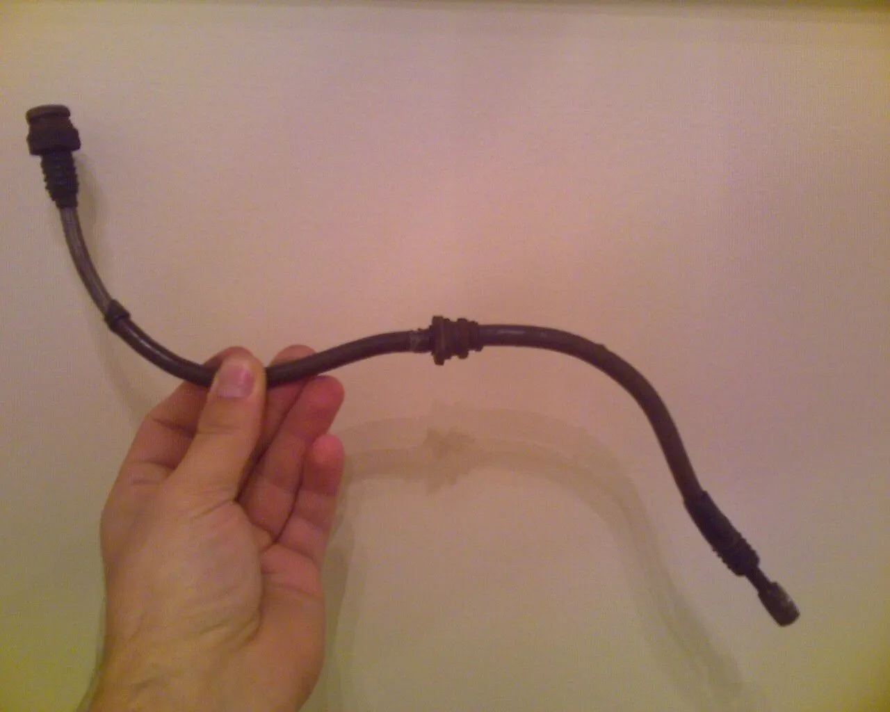

Let me clarify my previous comment. Looking back, the corksport line that failed on me this month was on the car since 2004, so 5 years it lasted. The pictures show (as good as my phone camera can show) where it failed. The clip in the middle, on the side that flexes with suspension travel.
I guess I should have been more proactive about checking the lines for wear, but I did expect lifetime from them.
The two rears failed because the rear crossmember has a sharp edge and the lines wore against it. They failed in 2008, so 4 years they lasted.
Finally, I'm considering getting single replacement lines from here forward from summit racing. They have some from $18 to $25 each. The only problem is that the ones that don't require any brake hose fitting adapters (most are AN 37degree fittings) has no coating on the outside of the steel braid. Any SERIOUS suggestions about how to increase the impact and corrosion resistance?
I put fuel line around the outside of my rear lines to protect against the rear cross member.
