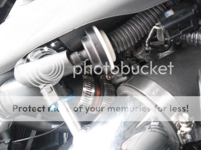

No prob. I'll take a quick pic after work and post it up. Running recirc is no problem at all, you "could" get away with the stock recirc. hose but with a little kink, extending it 1/4 with the copper sleeve (that costs $1.00) is not difficult lol... Thats no reason to run VTA. Its plenty loud in recirc, I think much louder than folks think (scares small children and families in mini vans).

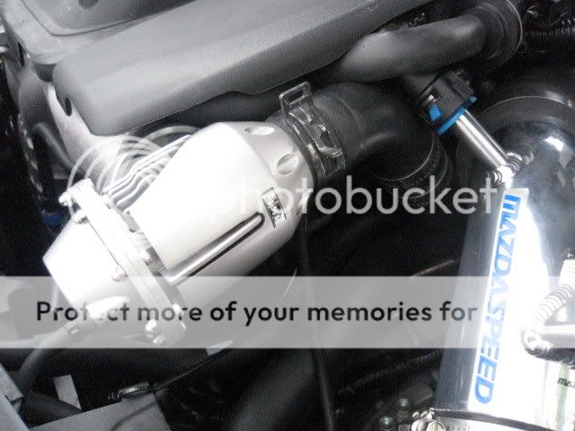

Here are a couple pics. By adding that 1/4 or so of length I avoided any kinking of the stock recirc. hose. Also, crappy vid I took. Turn volume up! This is only 2-3 psi mind you and its much louder in person actually driving. But you can get the idea of what it sounds like.

Well, its really a nice piece. Not having to adjust springs, shims, etc is the reason I went this route. It sounds great, and spool up comes on much quicker than the stock valve. It does whats its supposed to and no f'n around. Done deal.
thats the kit I have. The recirc. fitting is included from HKS. This is the bolt on specific piece which bolts right in place of your stocker. No addt'l mounting plate.
