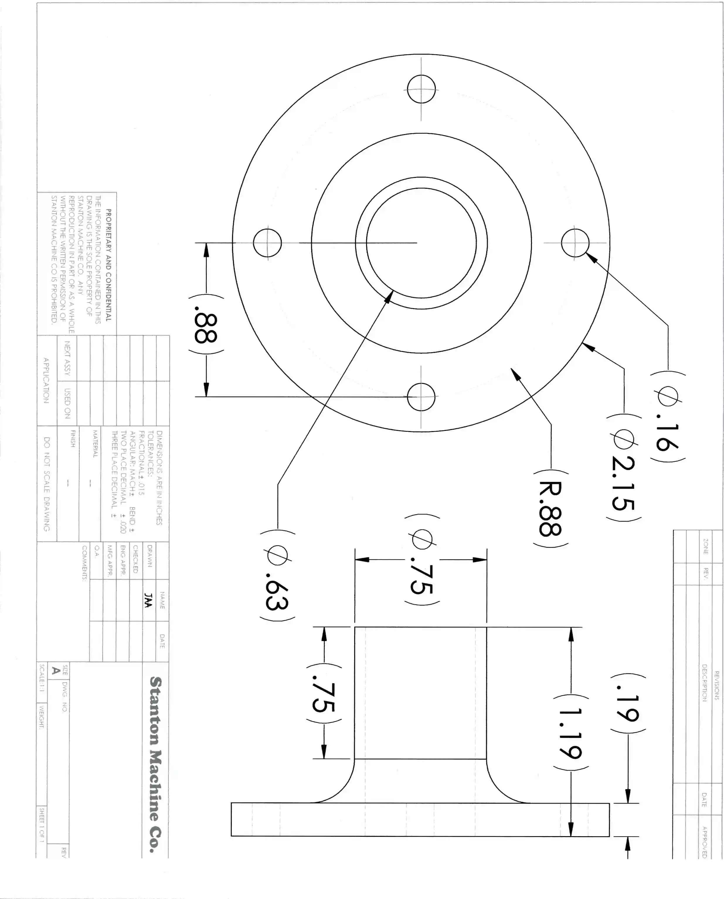

Stock IC pipes..screw that HKS pipe, i had one custom made!
hey i ran into the problem of installing the HKS SSQV BOV on the car, so instead of payin 90 bucks or more for a universal pipe that requires welding, i had my friend's dad custom make one out of aluminum, and it uses 3 hex screws to hold it to the BOV. it plugs right into the stock IC pipes with a hose clamp.
