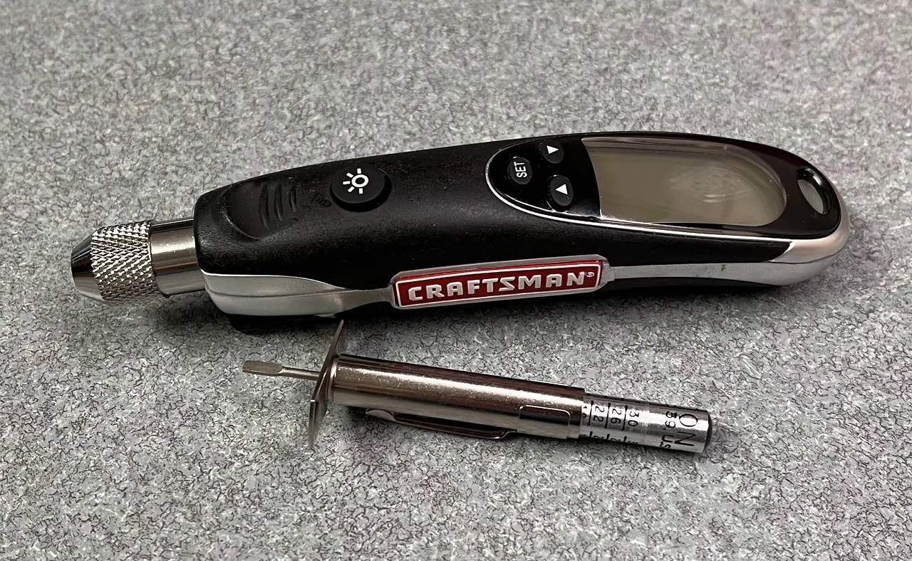

On my CX-5, when I'm ready to readjust the tire pressures, here's basically what I do:
  • Late in the day, inflate at my local gas station. 40psi, usually. Then drive home and park.
  • First thing next morning, adjust pressures and verify using an Accu-Gage pressure gauge.
  • Reset the system.
  • Every other time I adjust the pressures, I check the spare tire.
  • As my driving is almost all pavement, and almost all "regular/sedate" driving, I don't concern myself over side-to-side performance differences, changes based on surface differences (ie, gravel/dirt versus pavement, track vs street). The same essential pressures I use vary slightly front to rear, but otherwise I just ensure the adjustment keeps them seasonally where they need to be.
If I've had dramatic temp changes in the area, I'll often re-do the pressures to accomodate that current temp range. My area tends to not get huge temp swings from one day to the next, aside from the seasonal changes.
