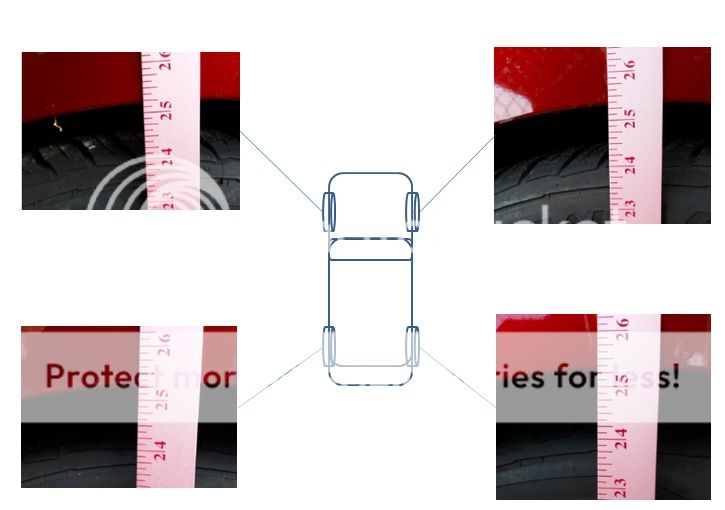

What was the condition of the car when you got that cornerweight? How much gas? Did you already have the big brakes, or was this prior to the install? What wheels/tires? Anything else that would affect weight? (Spare removed, carseat(s) installed, crap in the trunk, etc.)
I'm a bit surprised to see the 57/43 split, I really thought it would be a bit better. But the 3446 weight is promising. With the 34lb savings of my suspension and wheels/tires (compared to stock 16"), and removal of the spare, I might be below 3400 curb weight, that would be pretty decent.
ms3 brakes, rsb and wheels were on for the corner weighing. I made sure she was empty. I have no clue where the gas was.
I expected the weight to match from left to right but as you can see, it's bias is to the left. is that normal? also, note the difference in caster. I would assume that should be within a tenth if not matching. I brought it up to them and they shrugged it off saying it was normal.
Remind me, what wheels? (I'm on mobile, so harder to search) Did you ever weigh your wheel/tire package compared to stock? Did you weight the ms3 brakes? I would assume that they added about 5lbs per corner?
Cross caster isn't as big a deal as cross camber. But their allowable spec of 1.5 degrees is laughably high. Less than 0.5deg cross camber and cross caster is typically OK. (analysis retentive and racing types will aim for zero) Many OEMs will actually spec some xcamber or x caster to compensate for road crown (customers who don't understand the concept of road crown will make warranty claims for vehicle pull when the actual cause is road crown. Fun Fact: Florida is always the worst in these claims, as they crown their roads to 4deg,the standard is 2deg nationwide). Camber pulls positive and caster pulls negative. I have 0.4deg xcamber and while I would like that to be lower, my personal preference is to optimize (maximize) negative camber, instead of optimizing xcamber. So I tend to agree with the shop, 0.3 xcaster isn't a big deal.
I assume you weren't in the vehicle when it was corner balanced (unless you and your 5 are insanely light). With that said, the slight left bias is a bit unusual. If anything, a right bias in an empty car is ideal so that with driver (how often do you drive without someone in the drivers seat?) the LH/RH balance is closer to even. With the current LH bias, putting in only a driver will obviously make the balance worse. Your data would be strong data to support a lightening (or relocation) of the heavy battery currently residing in the front left.
Isn’t it good practice to corner weight with the driver or equivalent weight ballast in the seat unless you are looking to get a true dry weight of the car? If so, then this is ok. If not, the left bias with no driver is not good. Let us know if you can find a way/place to move the battery.

Yes, corner balancing should be done with driver (or equivalent weight). That's why i questioned what looks to be a weight w/o driver.
I can confirm that there is definitely a left bias with this car. It must be something with how they loaded it up. I set both the Fronts and the Rears equally the same using dial calipers and was surprised to see this as well. I didn't get the sense of this until I put the pics next to each other.
Note the car was not "empty" per say. It has some small cargo that adds very little weight but I am using a bigger/heavier battery. Future CO users might want to compensate for this L-R, just a little.
