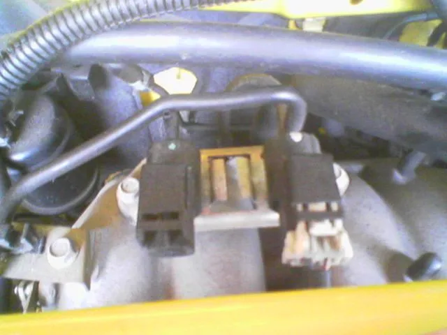

Just like the title says.......The first pic is right above the throttle body, and the second pic is just to the left of the first pic, note that only one is plugged up and having small hoses come from it. Is it supposed to be like this or should both be plugged up?

the one on the left is the egr soleniod
the one on the right is the connectors for the intake manifold, its for the vtcs & vics

So should the left connecter be plugged up with the little hoses? I'm having lots of idle issuses, so im tryin to figure if certain things should be plugged up n whatnot
EGR Soleniod huh? When i took it to a mechanic almost a year ago, he called it the idle air motor, so everytime i looked it up on the internet or a book, i found nothing, but at the time i was told that was the code my CEL was throwing. He said i can replace the "idle air motor" or maybe the intake was just clogged with carbon. So i've sprayed several cans of seafoam thru the throttle body, which works for a short time, then the CEL comes back

is the first one on the left pic suppose to b hooked up? or is it just suppose to sit there?
Yea i was wondering that too. its hooked up on the backside but not in the front. there was actually a plug like thing covering it up that had what looked like the mitsubishi symbol...so i duno
wait that pic on the left your talking about that little black piece right on the edge of the left right? sorry I was looking in the middle thats the egr one
that other one? hmm I know its hooked up but to what i dont recall off hand
Yea im talking about whats in the middle of the pic. I think AznXstazy was talking about the left edge of that pic
if your having idle issues clean your EGR that is probably the problem its pretty common
I think there is a how-to in the how to section on it

Yea i did a clean of that back in january, maybe not a good one, but after i got the egr back on, i notice i didnt put the gasket back on as well...lol. so i do need to take it back off for the gasket, so i'll do another clean and see what happens
yeah if your gasket is not there and its leaking thats probably your problem ;)

you are correct, it is the IAC, not the EGR
