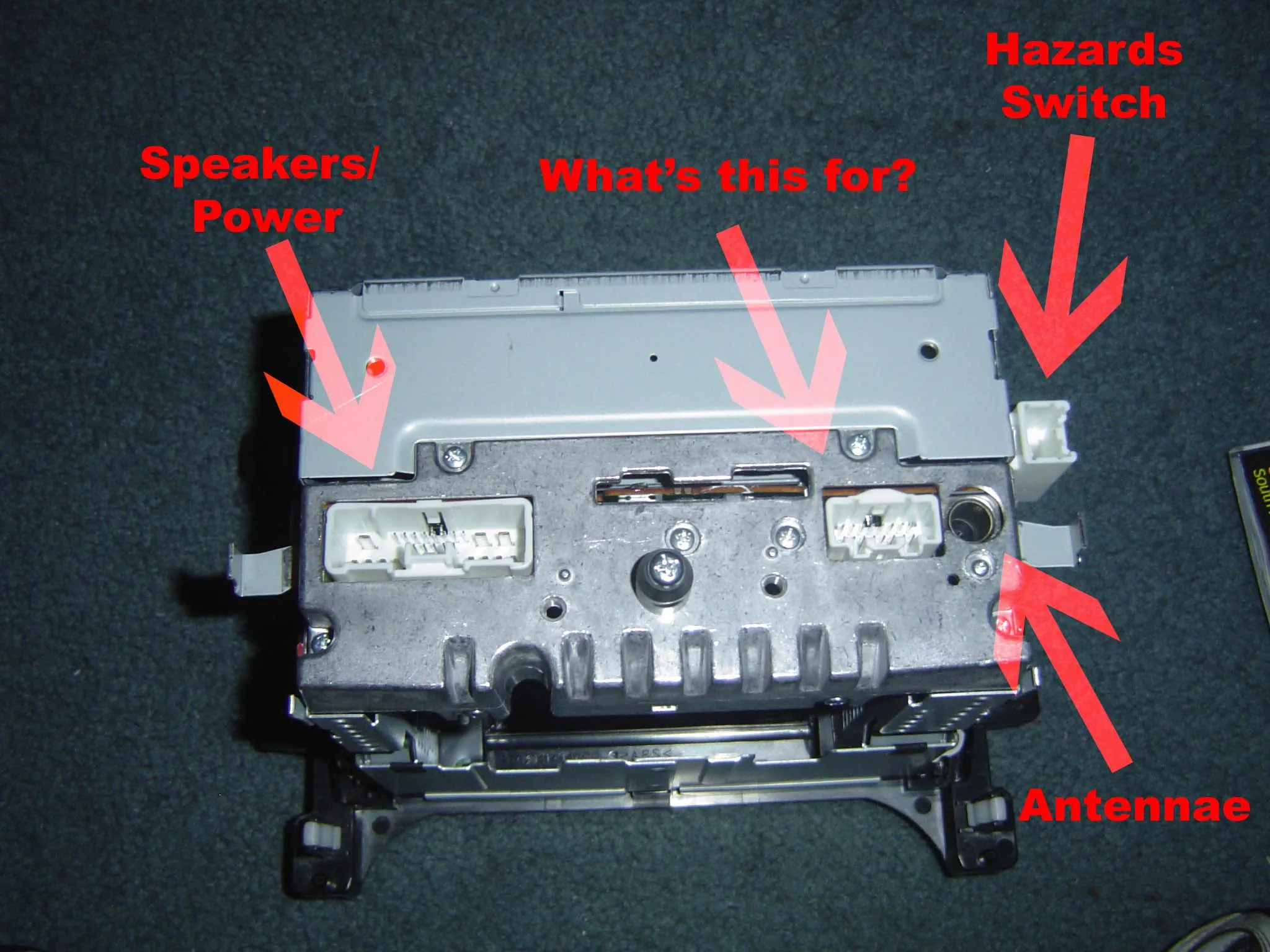

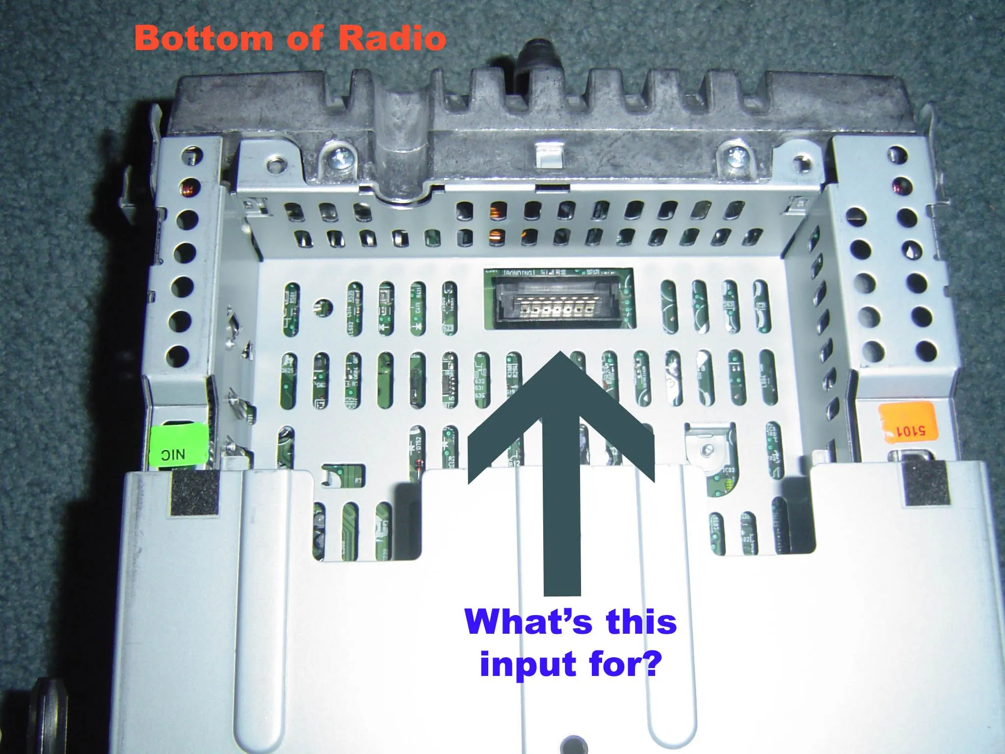

Fellow CX-7 owners:
I attached 2 pics of my radio from my 2007 CX-7, one from the rear and one from below.
What are those inputs, that are not labeled, for?
Also, which is the most cost effective way to add Sirius or XM satelite to my Mazda. I don't want to spend $300+ for a factory installed unit. There is got to be another way?
Thanks
Nick

I'd assume the bottom is for the CD changer if you had one. Probably just make everything modular so they aren't making half a dozen different boards.
The other one I could only guess is for the factory Sirius install.
the input on the back, just to the left of the antenna input, is for the iPod module from mazda. i just installed mine (which, by the way, i hate) and thats where it plugged into. as for the input on the bottom, i have no idea. but i know its not for the disc changer, i have the 6 disc, not mp3, cd changer and when i pulled out my head unit and saw that input on the bottom, i wondered what it was for.
anyway, hope i helped! :)

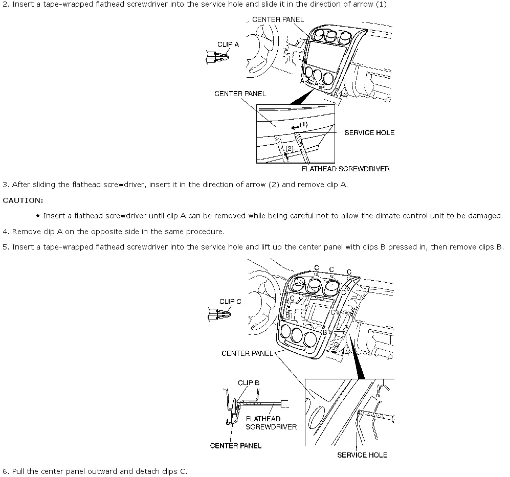

Hey NickyD, just curious how the head unit removal process went?
I have diagrams on where to start and where all the clips are.
Did you need any tools to slide the radio out? Did you have the
NAV option?
thanks

Here is a diagram that I received from RPM to remove the HU.
PuroMexicano said:
Can you provide those for us that are interested in removing the HU, thanks
