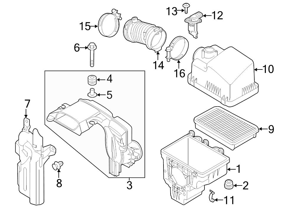

So what is the “bottle neck” from the intake system on the cx-5 that an intake provides gains? Is it the filter not flowing enough for its size and or is there a bottle neck in the intake itself possibly the snorkel part?
I looked at the intake pipe to the filter box and the diameter is not smaller than the throttle body so I dont think it can be restrictive there. Also bottom portion of the box where the snorkel connects is about the same as well. Perhaps the snorkel has sections that do create restrictions?
Assuming the snorkel is the only restriction, how about cutting out a “window” on the bottom intake box facing the fender side and attaching a rubber flap over it. So that under normal driving it is closed. And when accelerating harder or WOT it is hanging loose enough to open and allow more air. Similar to how the AEM air bypass valve.
Pic of what the OEM intake looks like.
So what is the bottle neck from the intake system on the cx-5 that an intake provides gains? Is it the filter not flowing enough for its size and or is there a bottle neck in the intake itself possibly the snorkel part?
Assuming the snorkel is the only restriction, how about cutting out a window on the bottom intake box facing the fender side and attaching a rubber flap over it. So that under normal driving it is closed. And when accelerating harder or WOT it is hanging loose enough to open and allow more air. Similar to how the AEM air bypass valve.
The oem airbox is actually well designed. Way better than any other mazdas I've owned. As far as power gain from switching filters or to an aftermarket intake. We will never know. Even if there is gain, it is minimal. However, the sound from an aftermarket intake makes the car "sound" like it is faster.
