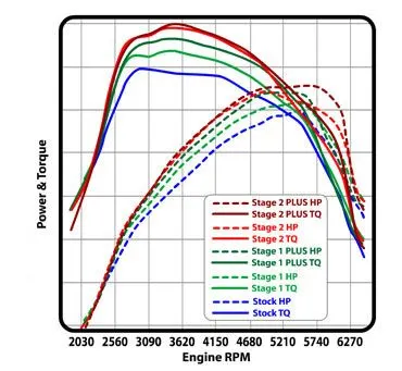

After running my car on the dyno with the AP (Stage1+mscai 93) I can confirm that the demo chart they show on the AP page is accurate. Power starts to die at 5600-5700.
To my knowledge, no matter how much your throw at your car, the simple fact remains that our turbo runs out of breath at 5500-5600 rpms. You can prolong the peak power i little further with AP, but it still falls flat after or around 6000 rpms.
Example: I ran a 9.2 constantly in the 1/8 when stock, I was shifting at 5800 - 6000 everytime. After looking at dynos for our cars, I decided to shift at 5600, and the very next time I ran, I pulled off a 9.0.

i just checked cobbs dynoe sheet for my stage2 tune and also the power drops off the same. I will be shifting as soon as i see it hit 6.
