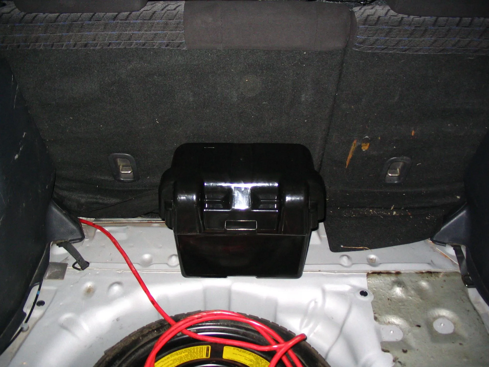

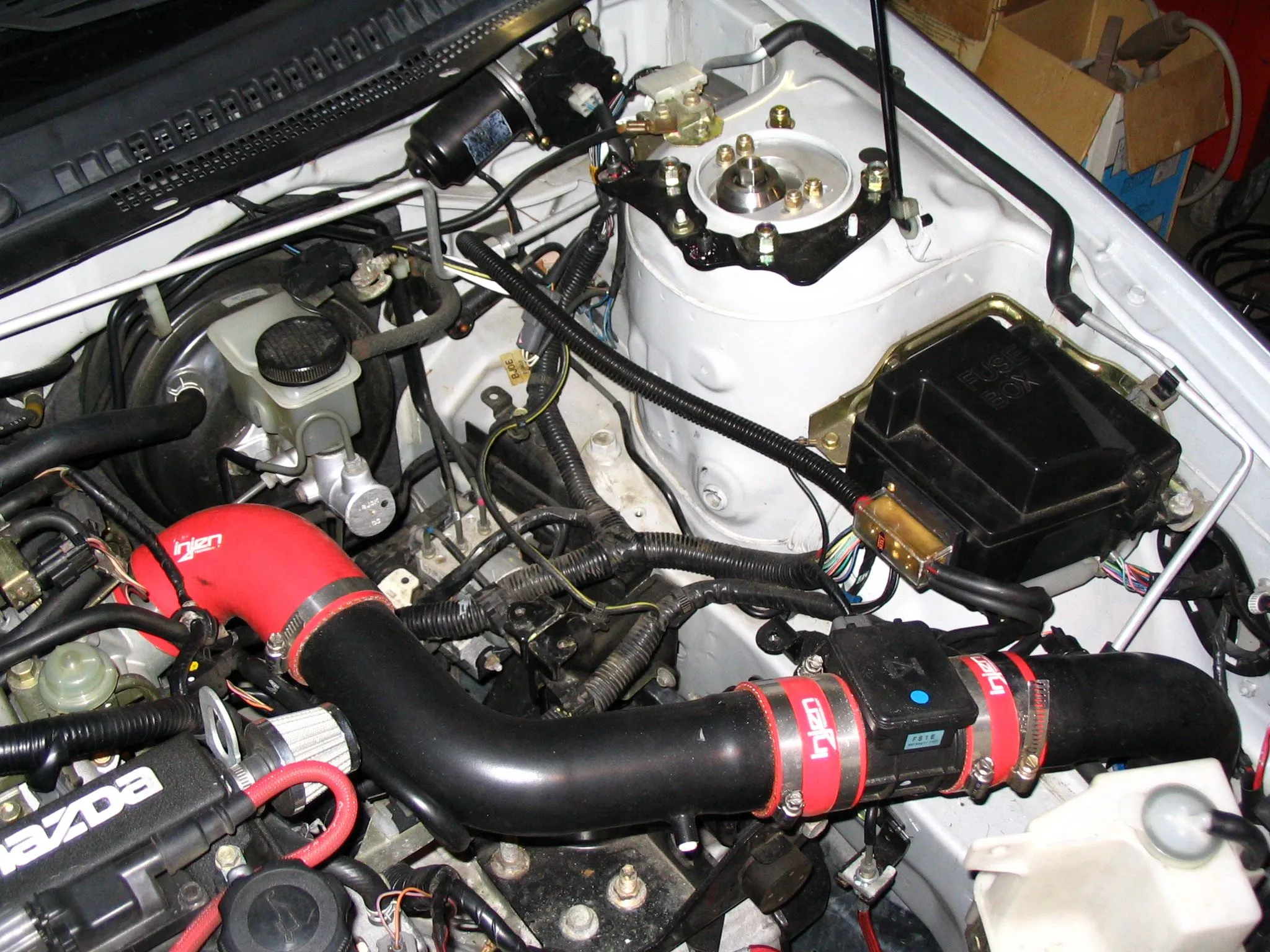

Actually the weight distribution on the Proteges is already front heavy. If all you do is go in a staight line then keeping the weight there is ideal, but not for handling. I've already moved my battery to the back. It's a pretty easy mod.
