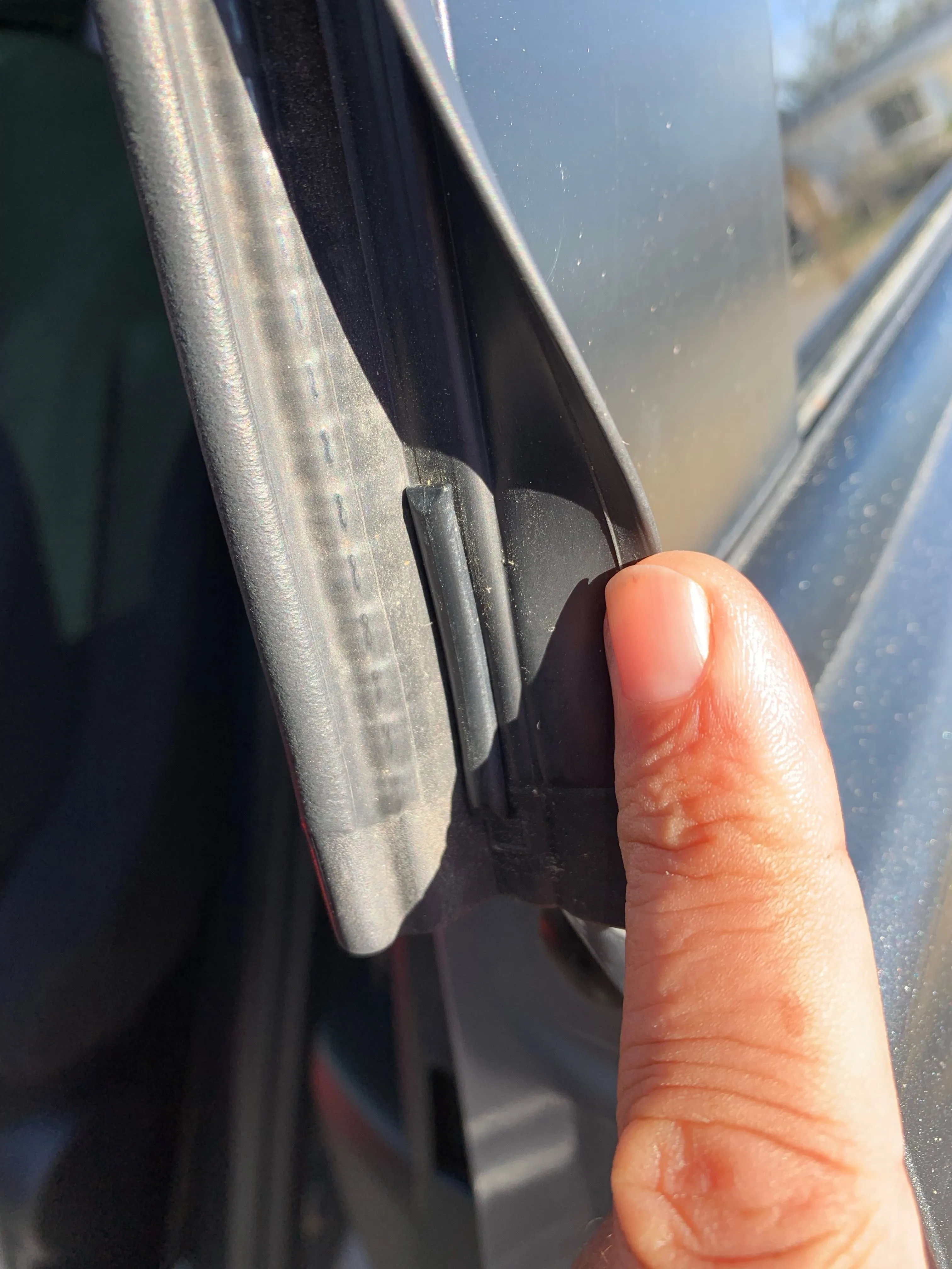

I'm trying to find these weather stripping clips/tabs for the upper window stripping for my 2012 M5. I've searched online, but can't seem to identify or find them. Anyone know where I can find these? Thanks in advance. IMG_0509.webpIMG_0509.webp

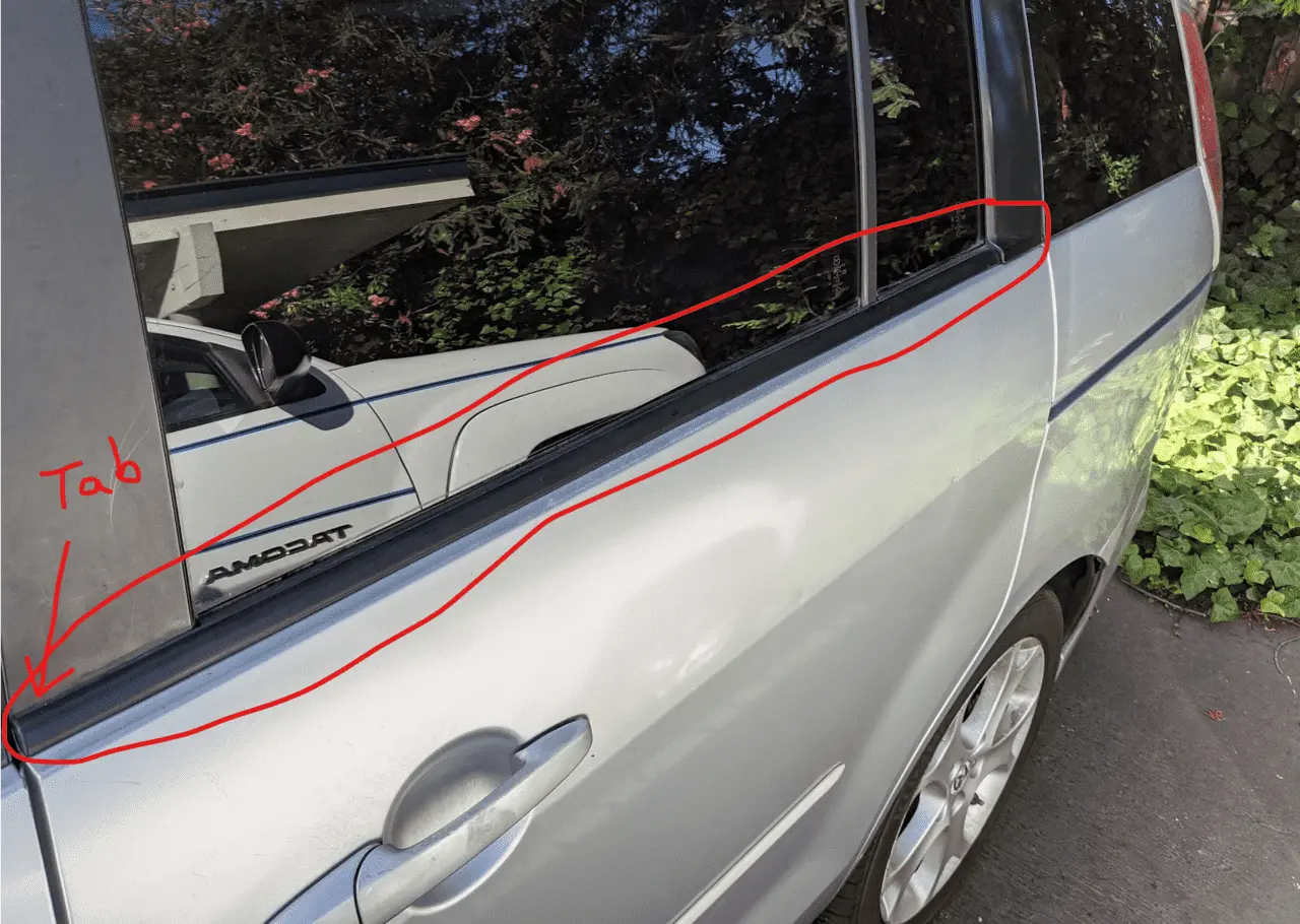

I'm trying to find this trim part, the long rubber thing and the plastic tab holding it in place.
I think this is something very common and generic.
What's the name of this part, or what is the part number?
Outer beltline moldings for the rear window is usually what they are called.
For a 2010 (left side\driver side) Mazda 5:
C235-50-670A​
Comes with the clip. Should be about $40 from your local dealer. I see them for $32 from online Mazda dealers.
Diagram shows that the tab comes with that part number.
Right side (Passenger side) is
C235-50-660A​
