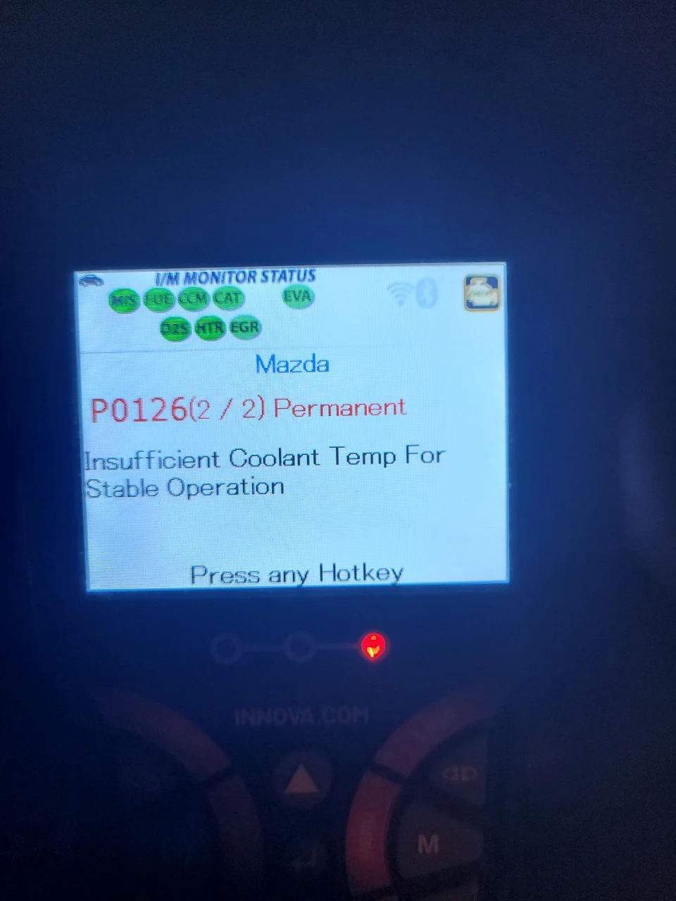

I got a check engine light with code p0126 driving home a couple days ago. Just dropped it off at Mazda and am getting the warranty work performed. Car just seemed to not get past 1/3 on the coolant temp gauge when driving at freeway speeds and the code appeared.
