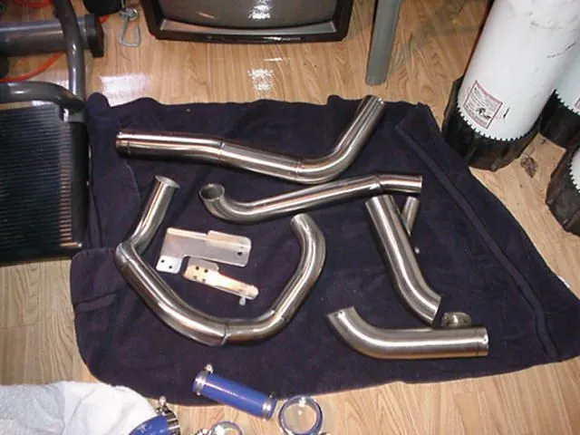

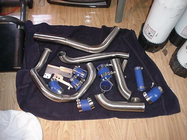

My kit showed up today atleast most of it did. just waiting for my airfilter and my BOV and bolts and i will be all set. core is smaller than i expected but i am actually glad about that because i don't want all the extra weight of a huge core infront of the front wheels. all i care is that it doesn't heatsoak and flows better when i am on the road-course. here are pics of what i have so far, all the piping is stainless which is nice unlike the hiboost kit. do i need to relocate my coolant overflow? if so where?

I remember seeing Sherberts relocated IIRC, I even looked for that reason. The air filter gets tucked between the coolant and battery, so the coolant tank is moved towards the front like when using an Ingen CAI. Atleast I think...
bill harvey - word of advice (since you're going to use it on the track) find a local place that does stainless welds and make a bead of welds on either end of the pipes. Otherwise, overtime and under boost your hoses will pop off. That is the reason why we bead roll all of our piping that require silicone hose & T-bolt clamps.
good advice...
