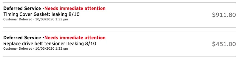

Video of belt tensioner leaking and leaking timing cover gasket
First of all with my first post here, I'd like to say thank you to all who contribute here. I also want to acknowledge that there is already good information posted in these forums about what to think and/or do about a leaking bent tensioner and leaking timing cover gasket. I had a Mazda dealership recently perform an oil change on my 2015 Mazda CX-5 GT and mid-service they provided a video and recommendation for replacing the drive belt tensioner for $451.00 and also timing cover gasket for $911.80. I attached a slightly edited version of the video I received. I edited the continuous video to take out my license plate in the beginning and end. This is no doubt my vehicle. I declined the services. What do you think about the findings that are shown in the video? I'm thinking I need to do my own investigation? This is the first time I've ever experienced getting a video like this and wanted to share it here. Thank you in advance to anyone who takes a moment to chime in! 2015 Mazda CX-5 with 51k miles as of October 3rd 2020.

OP,
I think your dealer guessed where the oil came from. So, they prescribed tensor replacement and gasket. Did they tell you why they think so?
Firstly, for only 51k, your engine bay is dirty. Did you own it from new?
Secondly, my tensor looked like yours on my '16 Mazda6 (45k). There was some oil stain on the alternator also. I suspected that someone spill the oil while filling the engine oil.
Anyway, I cleaned up the stains, and keep checking it every weekend.
So far, I have seen 0 sign of fluid leak.
On the web, I have read that some bad mechanics intentionally spill some engine oil. Later on, they tell owners to replace this and that due to fluid leak. Need to protect our wallet.
My recommendation: Clean up the stains and keep an eye on the engine.
If stain shows up again, you got a real problem to fix.

The dealer service department did not say how they came to their conclusions and recommendations.
Dirty engine bay: I am the only and original owner. I guess I should be cleaning the bay. Do you have any recommended products or just good ol' soap and water?
I will clean up the stains and continue to watch for now, thank you!
