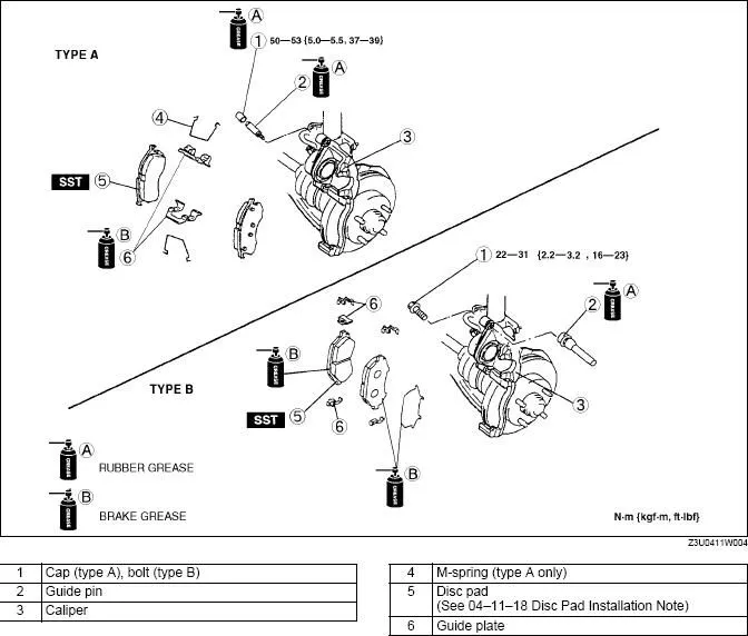

You're looking at the #2's. Just get a little tub of brake grease, grease the pins, and slide them through the hole and repeat until it's smooth and there's no grabbiness.
sanblaster1 said:
Should be two on each caliper if I am not mistaken.
yeah, but the ones that are not "removable" are inaccessible without disassembling the entire caliper. Also, those ones are pretty much sealed, so they *SHOULD* be fine. Also, that diagram is for "Front Brake Removal / Assembly" from the shop manual, and it says nothing about greasing the other pin. Oh, they'e called guide pins in the manual, same concept.
ahhh I see. The howto on this site does not mention lubing...I am going to post in it now to see if I can get someone to update it.
So only the guide pin you remove has to be lubed right? ...with brake grease?
