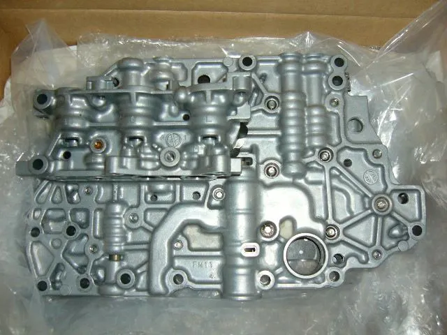

Hey guys and gals. Got the valve body from Lentech today. I will be putting it in tomorrow and post the results. Here are the pics of the front and back.
UPDATE
IT'S IN!!! Man I cannot believe the difference in the shifting. And I cannot believe how easy this mod was. Great upgrade for the money and the time. Give me a few minutes to try and get something going with the pics on photobucket.

well there has been a set back. I got to looking at the valve body and wondering why there wasn't any solenoids in it. according to the website the new valve body is supposed to come with them, so I gotta put this off until next weekend and call them on Monday. Sucks.
