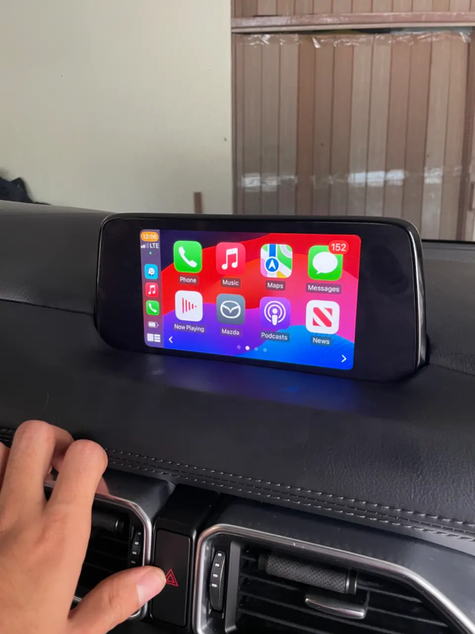

Hello guys! Just to share that i finally did the upgrade to have wireless carplay/android auto on my CX5 2018…. As everyone knows, first step is to upgrade the firmware of the system to at least 70.00.100 …. (If you need to do this upgrade you gotta first to do it from your original/standard usb adapter NOT from the new one)

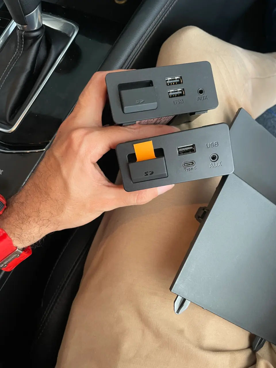

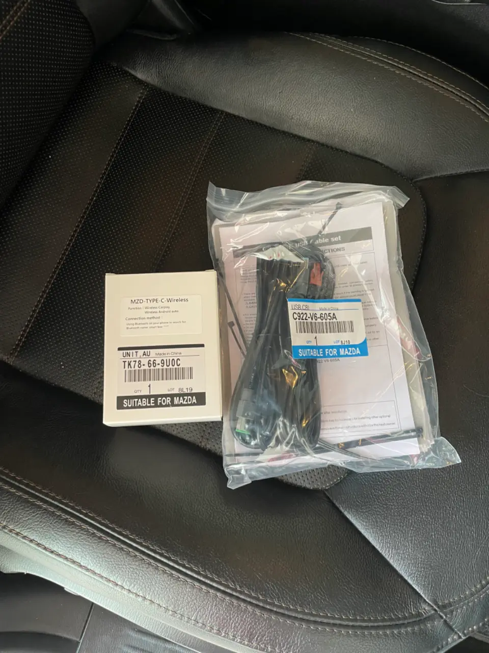

Then, i ordered from Aliexpress the usb Adapter/Hub replacement, the one that is wireless and type C.
Then proceeded to take out the original usb adapter from the resting arm, routed the new cables from there to the dash (is not necessary to dissamble the entire center console).
Just plug in and everything is working flawless
