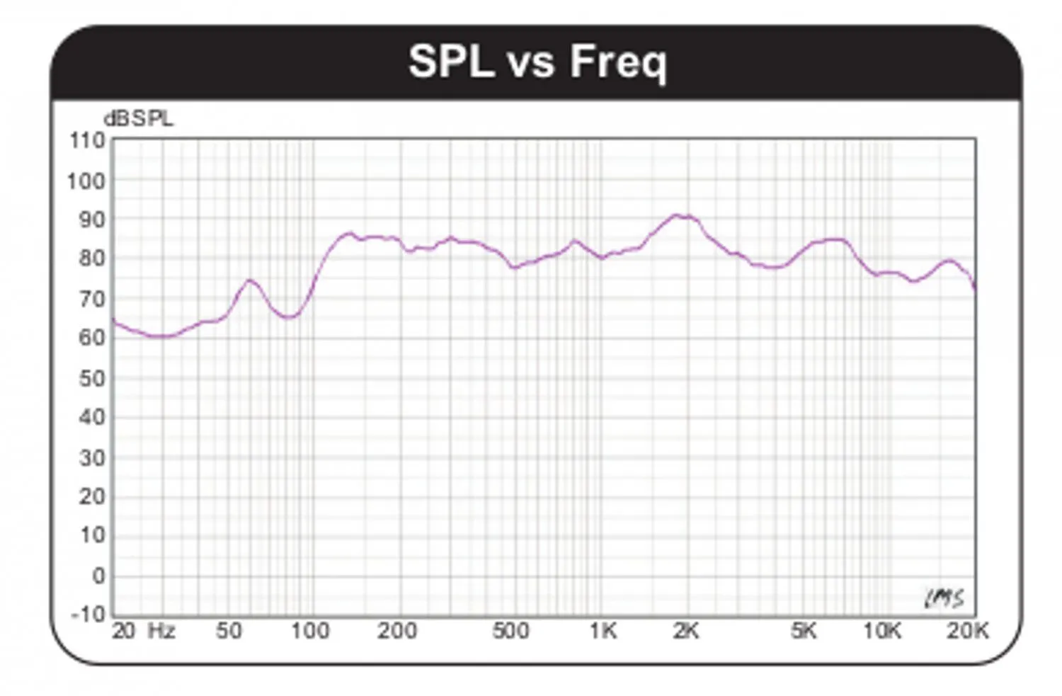

With the info above, I went looking for replacements. No car audio speaker makers publish response curves and none would give me any. Looking through audio and hobby sites, I landed on 2 speakers at Newark electronics. One a 3.5" and the other a 4". The Visaton FR10 does in fact sound good and sounds like I would like the system to sound. Alas, it will just not fit without significant surgery and the cover would not likely fit. The 3.5" will fit with minor clearancing for the magnet and is a pretty good second. It is a MCM Audio Select 55-5675. Here is the published response curve:
This curve is smoothed, but doesn't have any pronounced plateaus to obviously color the sound.

These speakers are not perfect. There is some upper bass/lower midrange "missing", but that may be caused by the crossover the Blose amp may have. Overall, a significant improvement. At 85 dB/w/m, they are between the center and corner speakers in output below their treble peaks and avoids the peaks altogether.

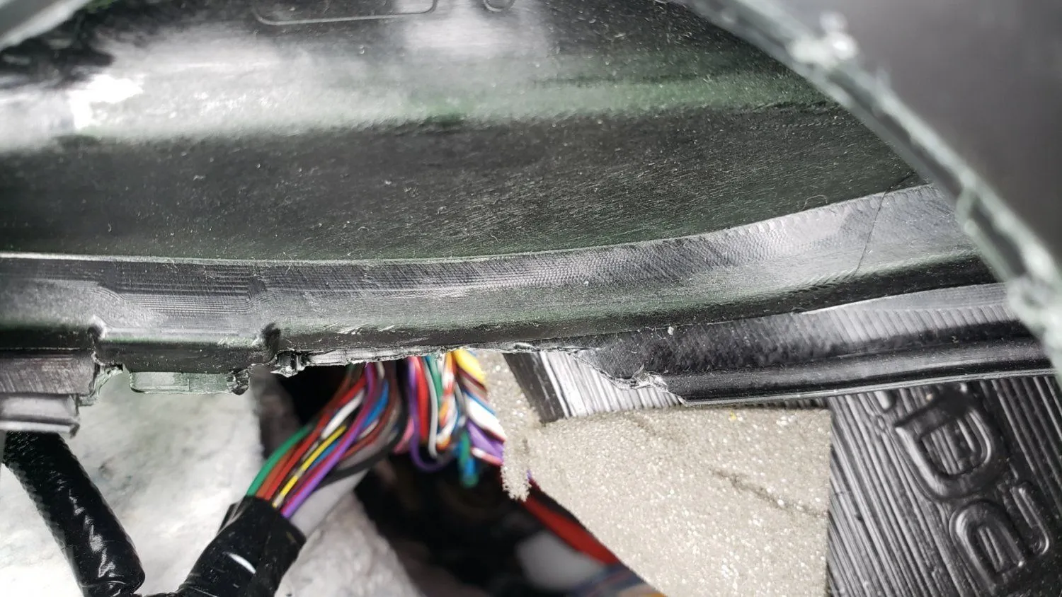

Here is a pic of the plactic I hacked off to get the speakers in. It is the edge of one of the A/C ducts.
A similar cut is needed on the right side.

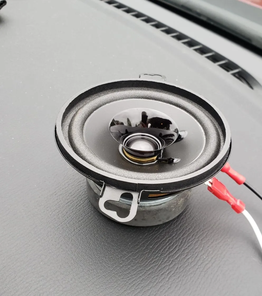

Hook up was super easy. I had a pair of Metra speaker harnesses from my 2006 Miata, #72-5600.
They plug in, but don't lock, so I used a zip tie. Looking at the OEM speaker, the positive terminal is on the left side of the connector, magnet down.
Final shot:
Don't be put off by the price. Newark essentially sells wholesale to manufacturers. Other makers sell similar looking speakers and they may well sound as good, or better. I just couldn't tell and saw no reason to gamble I would screw up the system worse.

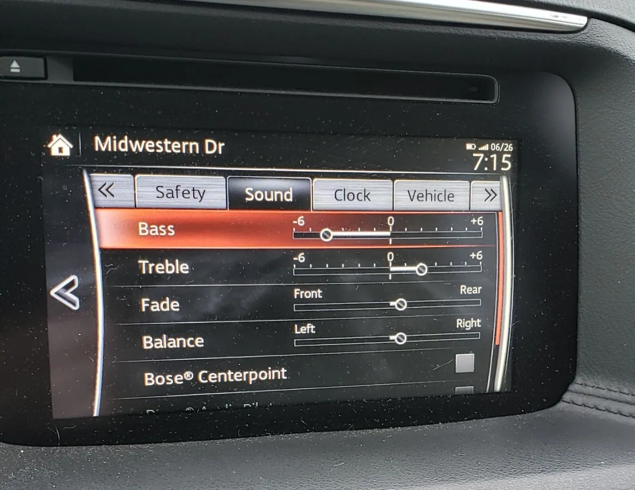

These are my initial EQ settings:
Where did you do the 'hacking'on the ac vent?
I just kind of crammed mine in.
The rough edge in the pic is where I cut. It is a seam for the 2 halves of the duct. If you don't cut is all, the duct won't open up, but it it does, it shouldn't be a big deal, where it is.
So, today I remembered an old trick. I tuned the FM section between stations to get hiss. The hiss is relatively flat from about 30 Hz to 15kHz. Using "Spectrum RTA" on my phone, I was able to determine the bass tone control is +/- 6 dB at 50 Hz. The treble is +/- 6 dB in a shelf above 3 kHz. With my new dash speakers, setting the treble to 0 and the bass to -6 gives a fairly flat response curve, but it still has a bump at 40 Hz of 2 - 3 dB and the 2 kHz bump in the MCM curve above shows. Otherwise, it's good and sounds balanced like it should.
AND, there is no lower midrange "hole" that I thought I'd heard.
