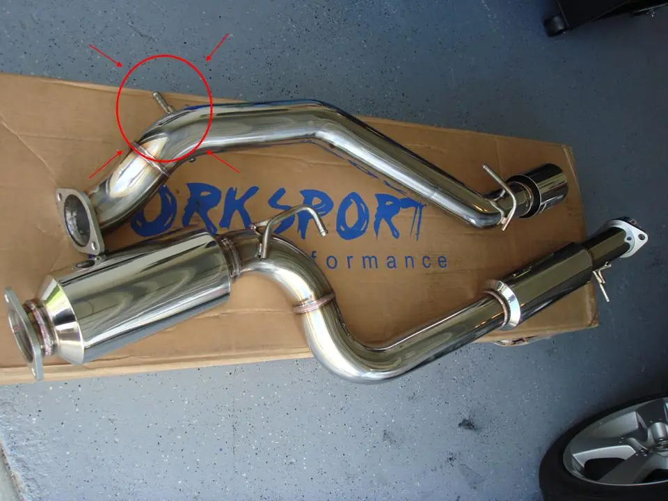

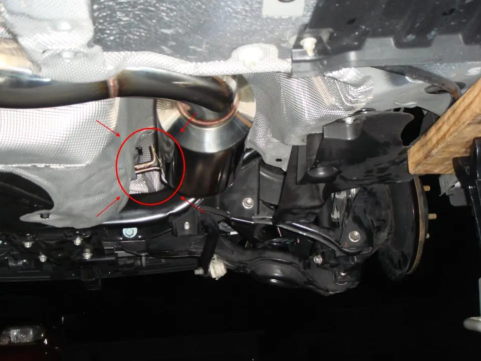

I'm pretty sure its this one:

Once I got home on Friday, I adjusted the exhaust and eliminated the rattle... The culprit was the rear hanger right over the subframe that was contacting the side of the subframe; the rubber mount was in too far.
I went out to run some errands and while making a u-turn heard another rattle; different one. But this one only happened during start up on first gear. I looked under the car again and found nothing.

Anyway, Saturday afternoon when I got back from the races I got under the car again and found all the culprits!!!
The front hanger on the front pipe contacts the cross brace...those hangers are really thick. And the hanger on the rear section right over the rear subframe was still contacting, but in two different areas. I really need to take pictures. I'll try to post some tomorrow. But the resolution was to make rubber isolators out of thick rubber hose. I wrapped the hangers that were contacting the brace and subframe with trimmed pieces of rubber hose and I capped the end of the rear subframe hanger with another piece of the hose.
I went back racing Sunday and the exhaust was solid!!! Not a rattle or clunk anywhere!!! It's perfect now!!!
The real fix would be to grind away some of the thickness of the hangers to make a larger clearance and shorten one of the hanger overall length.
