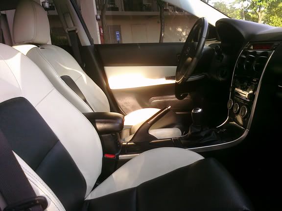

I don't have an interior "before" pic, but the middle "after" pic in my sig is kinda small, so below is a larger shot of it. Hopefully that will give you a better idea about the height of the Stage II. Please ignore the extra "skin" on my shifter boot... I was too excited about fixing the shifting issue, and forgot to get smaller boot at the same time! LOL I'll pick one up later though, and I can deal with it looking like granny's fun-bags in the meantime.
Stage II shifter 1" height drop:
