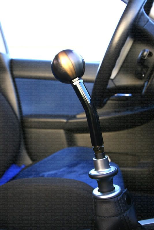

2 - Bent Shifter Extender:
I find that the shifter knob is too far away from my hand to reach comfortably (too far forward and down). I can get a shifter extender, which will move the shifter knob up. This will help a bit, but I'd like to also tilt the shifter backwards (towards me). A Bent (backwards) Shifter Extender would do the trick, but I can't find one anywhere.
Anybody know where I could get one?
Here's a picture of one (no longer in production and not for MSP):
