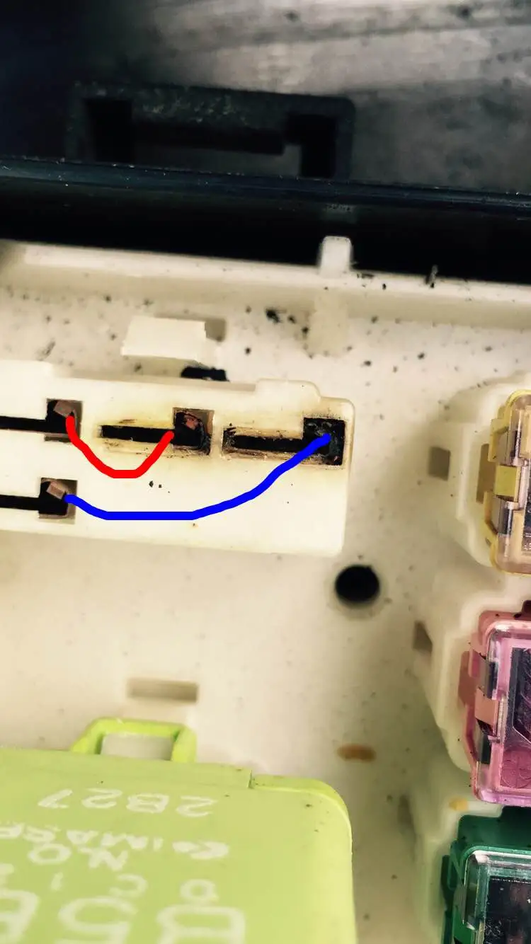

Here's the weird thing: i took pieces of wire and connected the spots where the relay plug in, and I hear the fuel pump running. Not for a few seconds, but constantly until i take the key out. But with the relay in, i don't hear it at all. Not even for a couple seconds. And it still doesn't start.

Here is how i jumped the relay connections...

Car did not start with relay jumpered. But can anyone confirm that the way I connected it would allow the car to run? Like i said, heard fuel pump running constant, but not with relay in.

If the relay or fuse was the problem, jumping it like you did would allow the car to run. You've eliminated those two as the problem.
