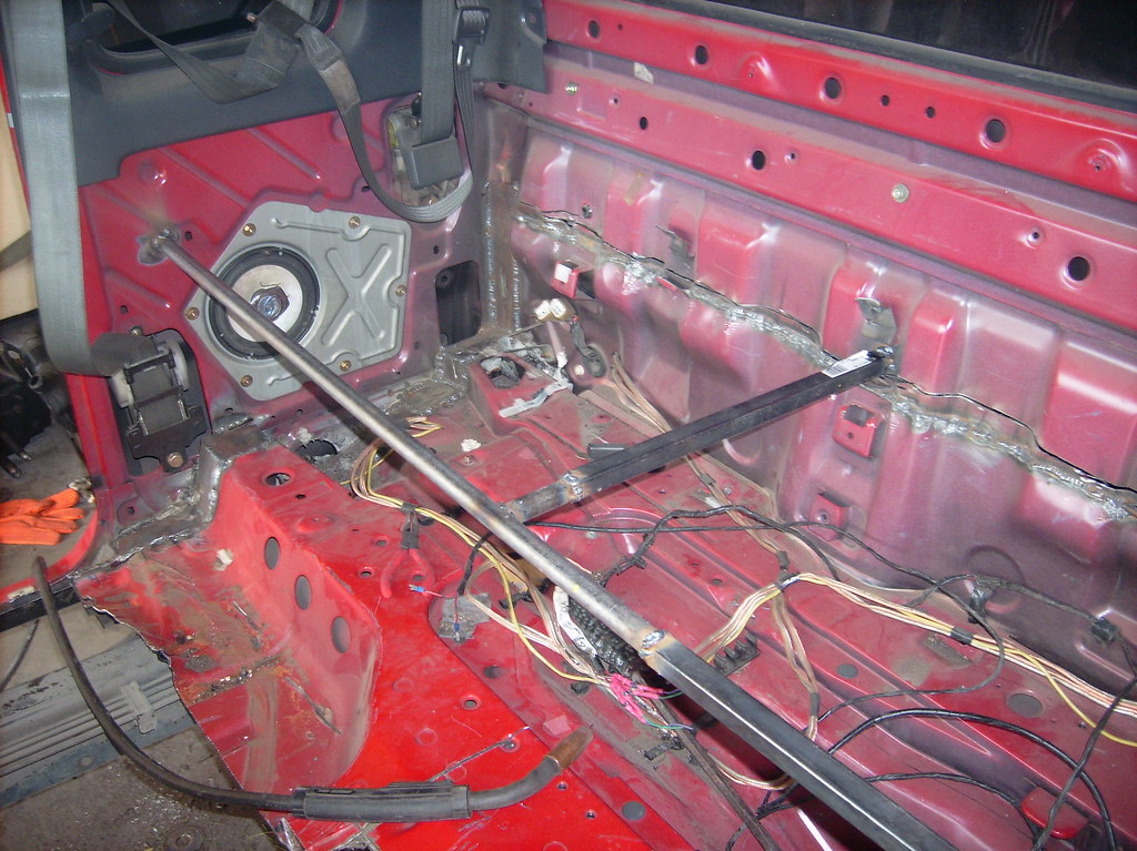

alright well i was getting to the point where i was getting a lot of flex in the cab and this is something u do not want. u want to be sure everything stays square for obvious reasons, i dont think i have to explain this one...

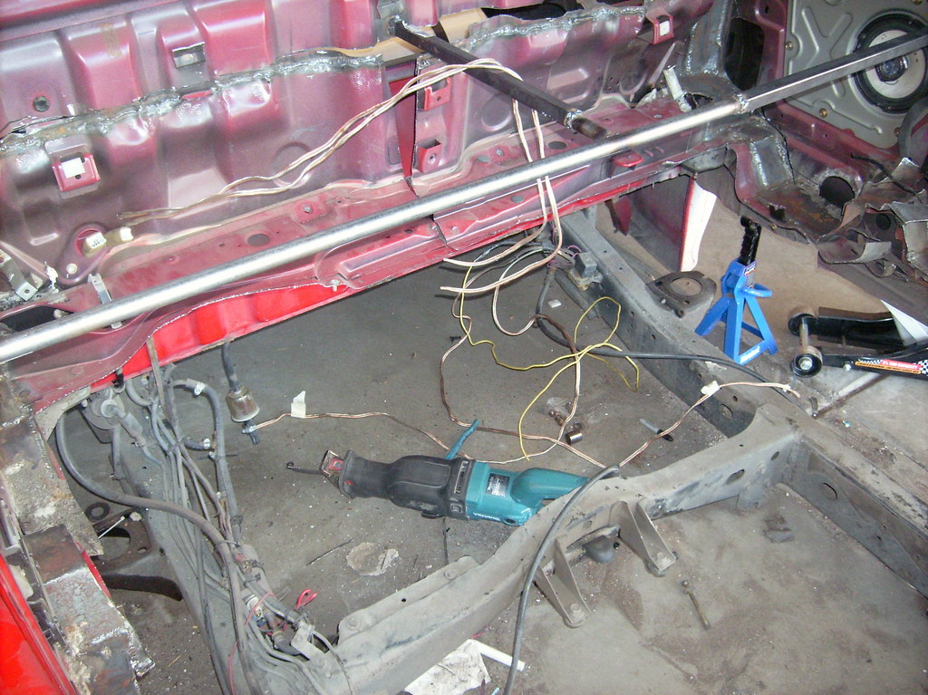

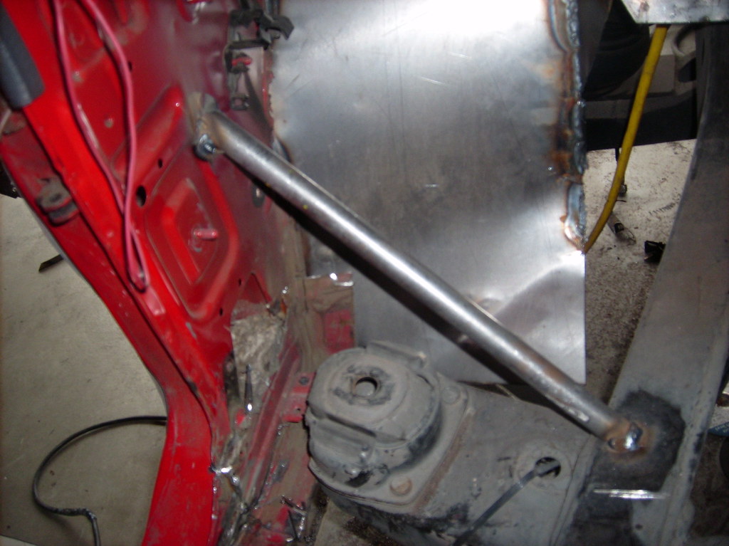

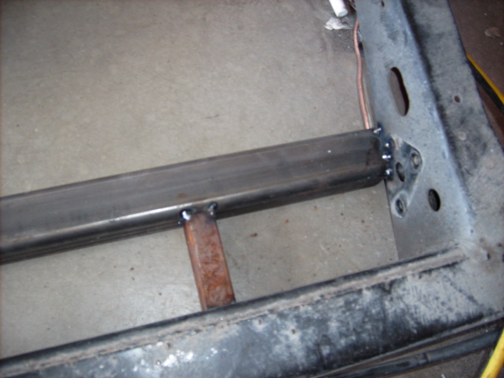

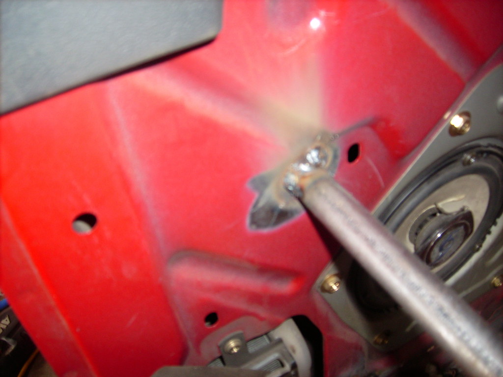

so i welded some round bar from the inner wall to the fram on both sides in the front to start with for support...

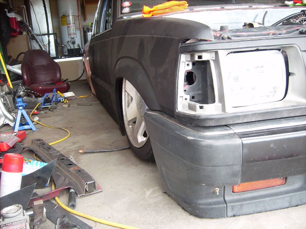

heres an underside shot showing the cap and the 3 inch difference between the frame and the cap. the cap will eventually sit flat on the ground..

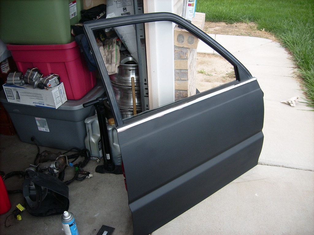

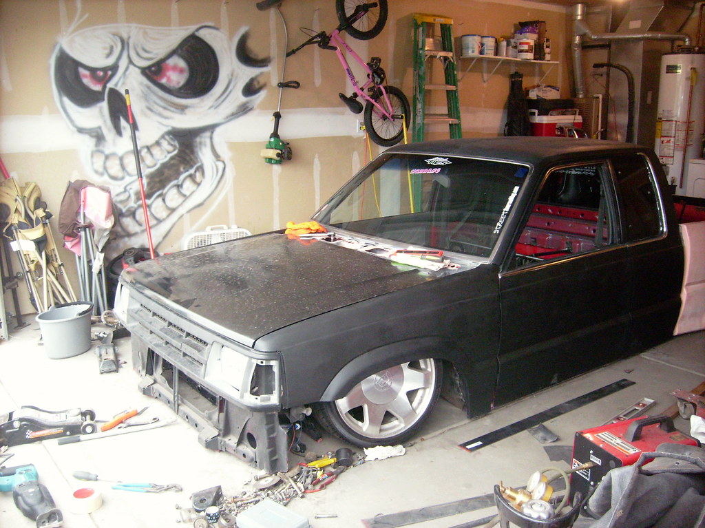

well i was informed by the president of our local chapter of Severed Ties that my truck needs to be one solid color for this show, no bondo, so i decided to flat black the whole truck. not super happy about this, but i think its gonna look pretty badass when its done and color sanded... rustoleum flat black is the only way to go when doing a spray can job...

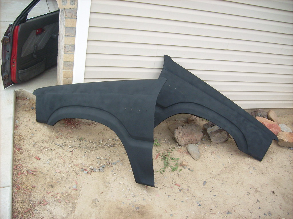

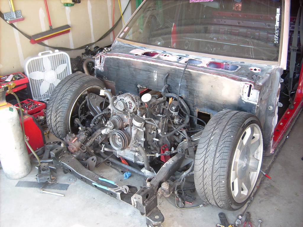

this is why i recommend the rustoleum. both fenders were done with walmart brand bad cans of black and they turned out uber splotchy. so i sanded them down and went over them with rustoleum after this pic...

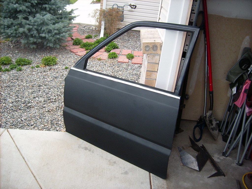

the other door, just cuz i can...

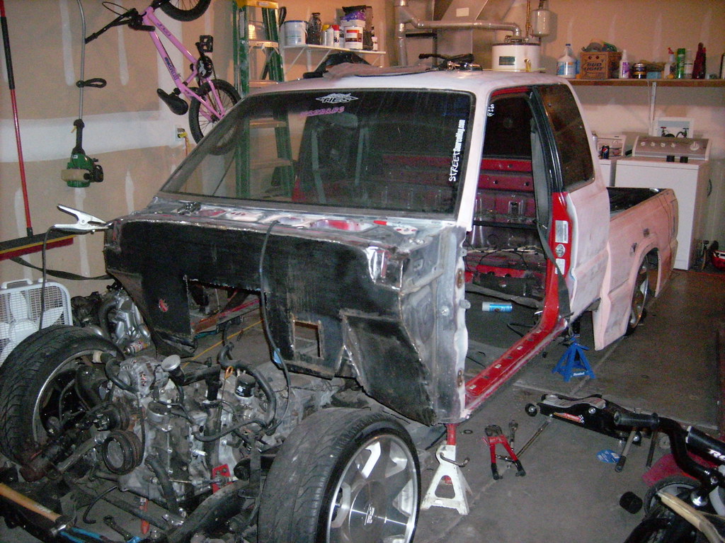

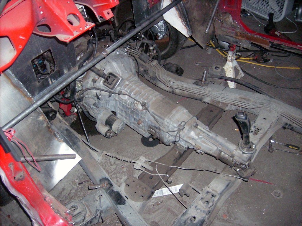

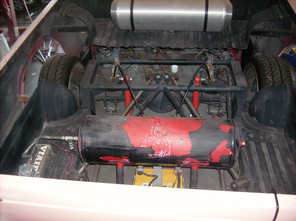

before i could cut out the rest of the floor in the back i had to brace it also. i used a 3 pt brace for this and it held up very well in keeping the shape of the truck after the floor was gone..

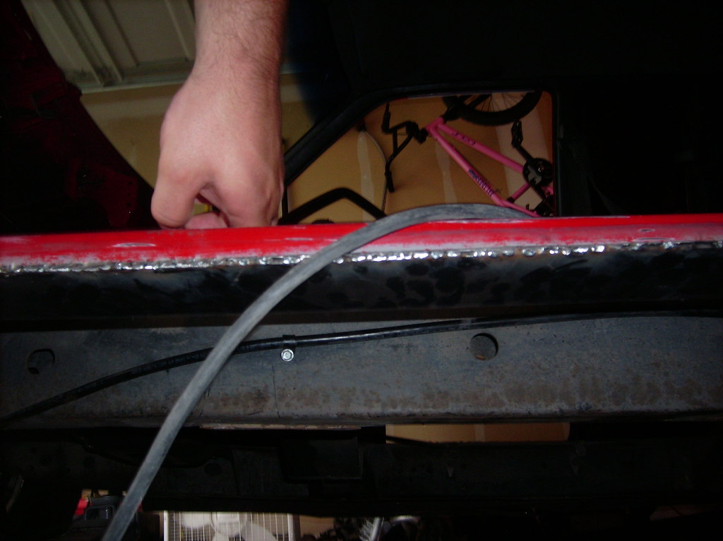

good penetration..

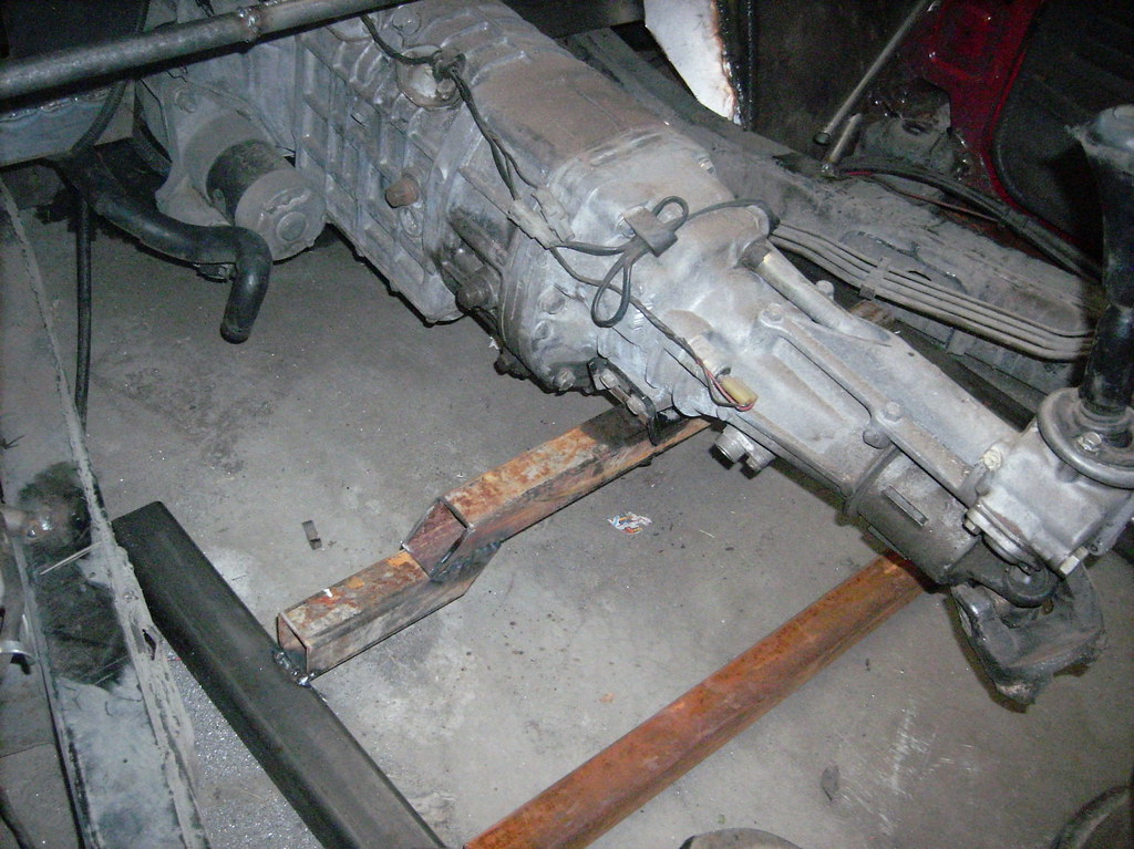

i also put a brace up frnt making sure that it will clear the tranny when the truck is on the ground..

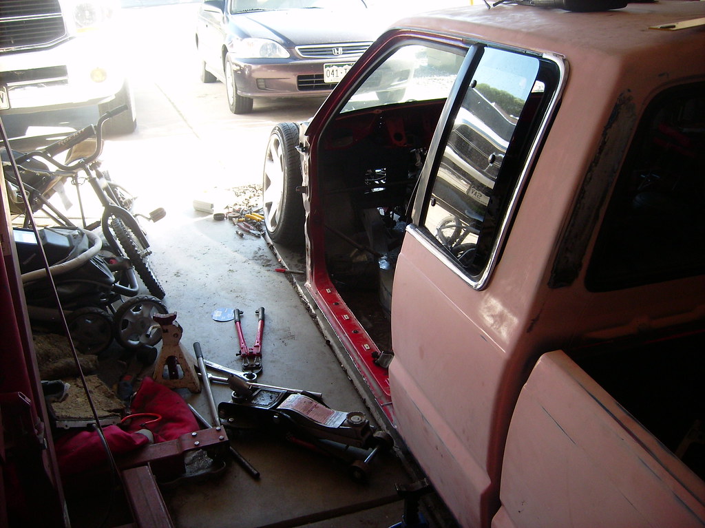

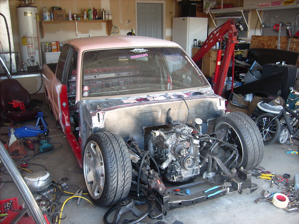

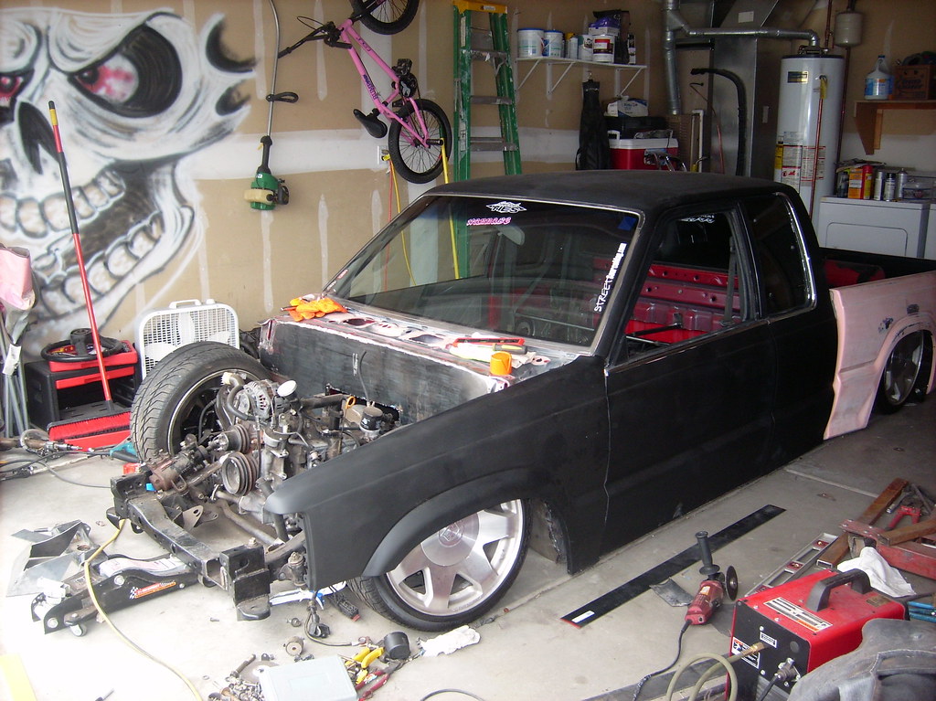

after the rest of the floor was cut out i cut the supports off the frame and jacked the truck up and put it on jackstands the rest of the way to do some more trimming...
monster truck..

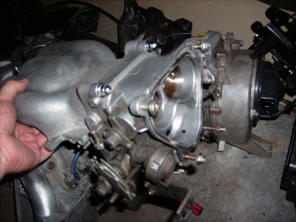

a little out of context but in the midst of this confusion the usps man brought me my throttle body i have been waiting on for quite some time now...
so i had to put it on my intake mani..

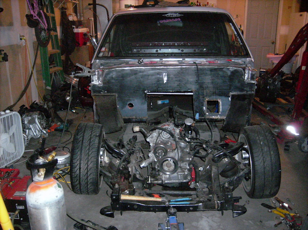

halfway there. sawzall blades r expensive, but i wouldve never gotten this far without one..
all the way cut out. now to pull the cab and trim the super thick jacking points where i have the jackstands.

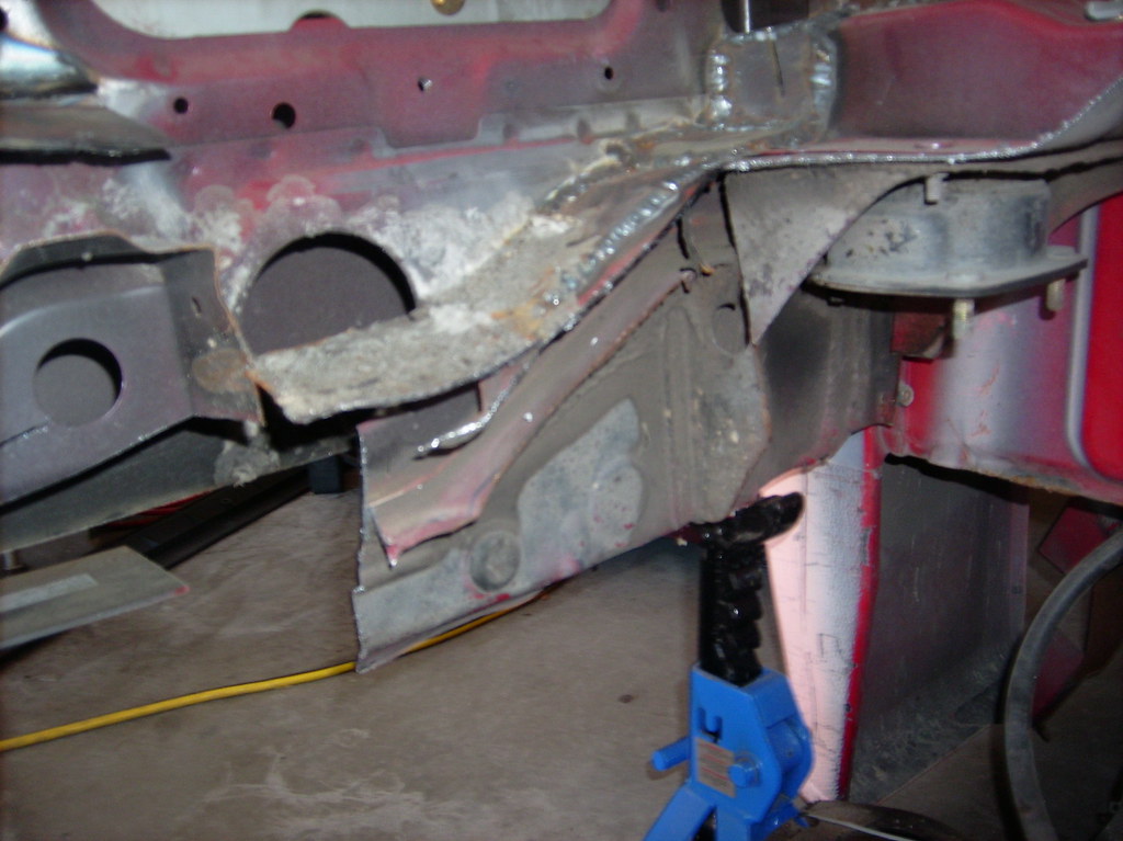

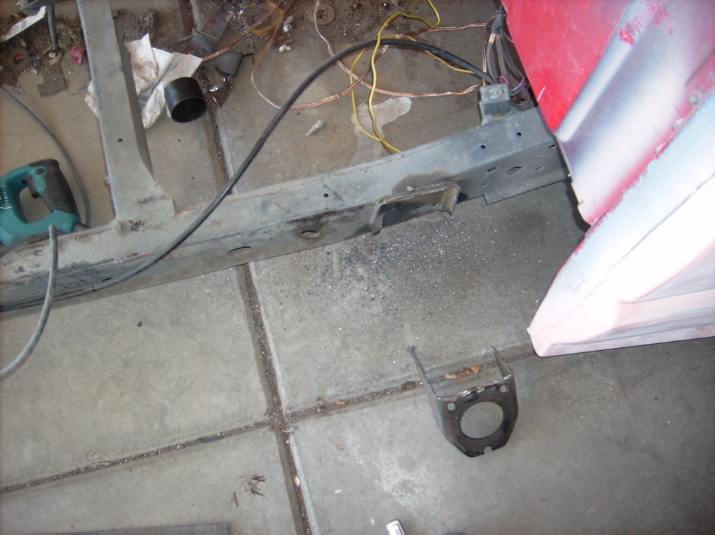

little pieces like this are what are killing me. this wouldve been so much easier if the truck hadnt been body dropped once before...
do it once. do it right.

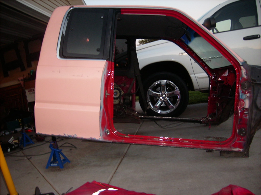

well its off the jackstands, but the rear cab mounts are in the way of laying out, but the front is damn near doored...

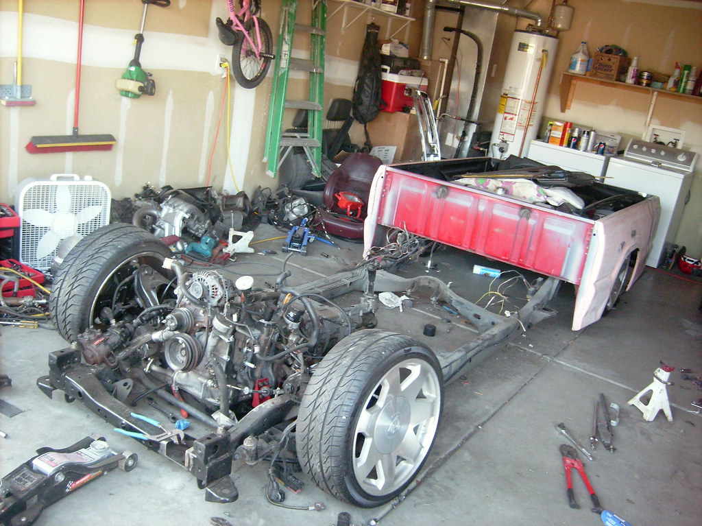

what good friends i have. after hours of phone calls and texts i finally got a buddy to help me...
this truck looks hella long without a cab on it. kinda weird lol..
the back trimmed up. running out of daylight...

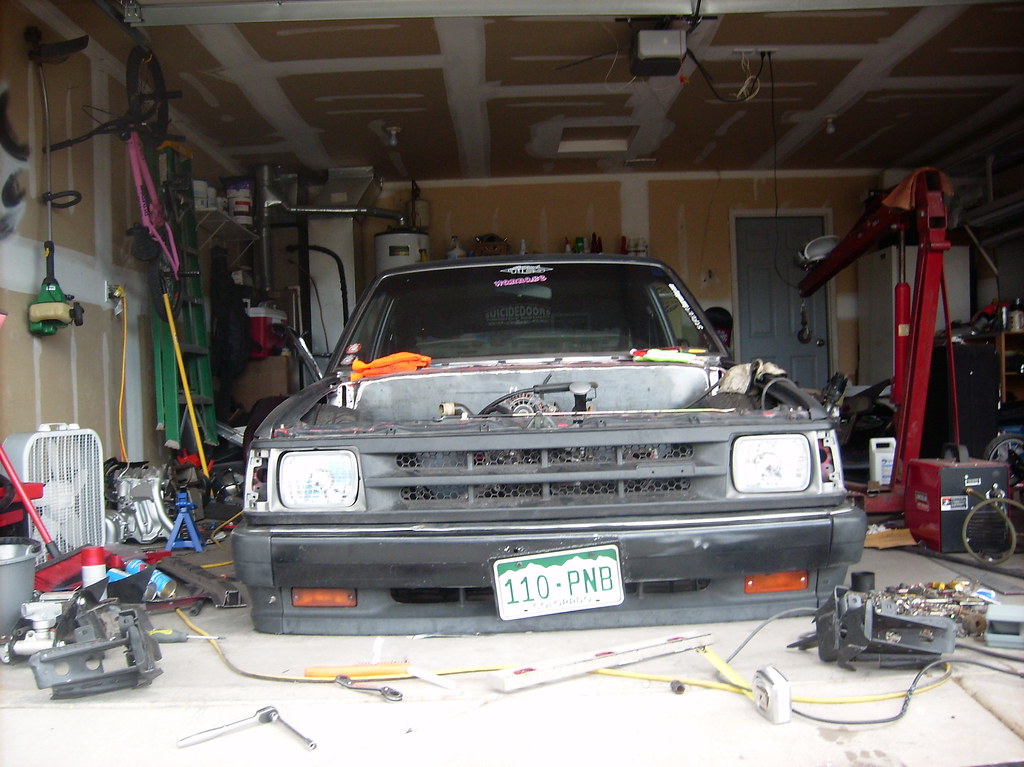

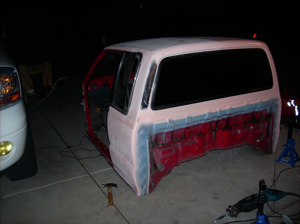

done just in time. well still have a little more trimming to do in the front but u cant tell by this picture and the fact its dark outside. goddamn i bet my neighbors love me..

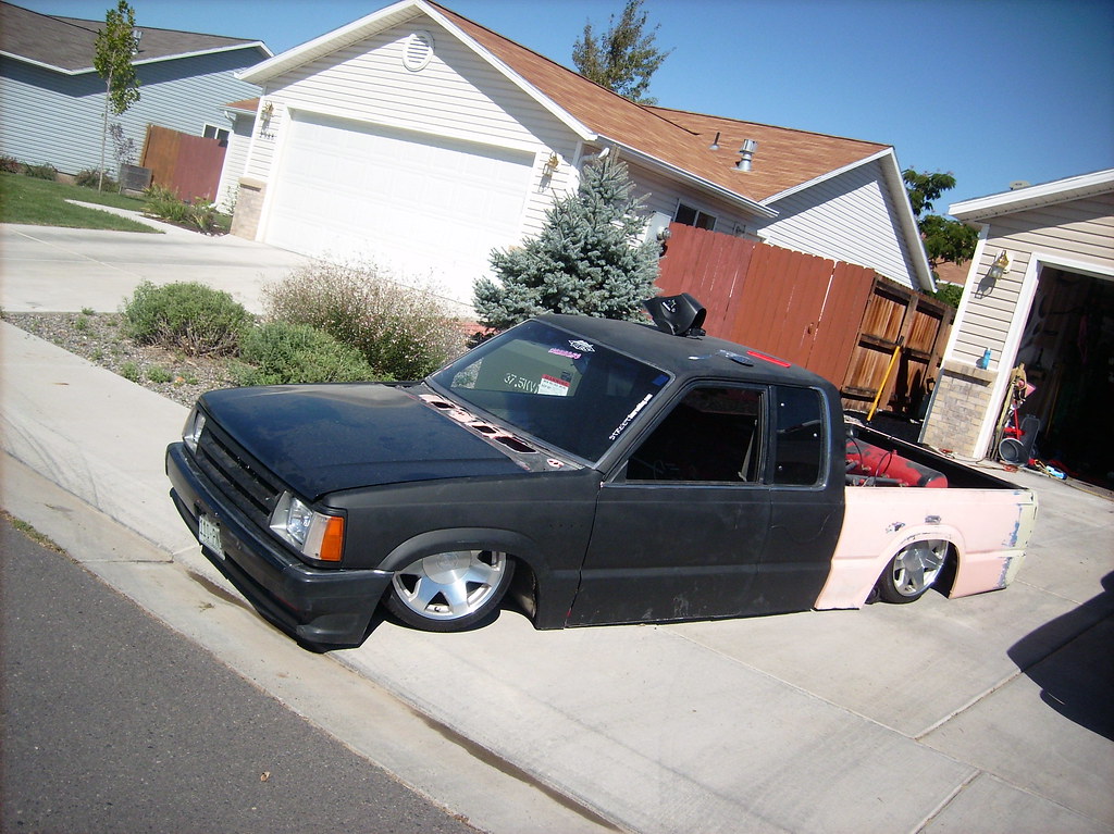

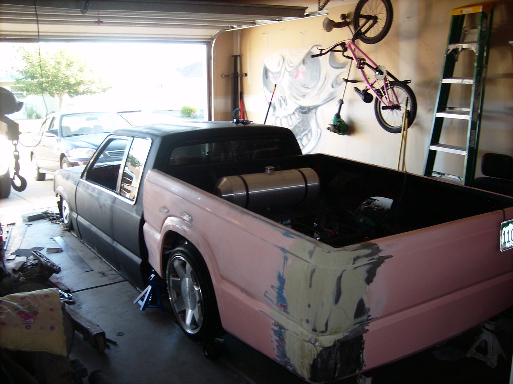

this is how low she will sit now. officially 45" to the top of the roof. im a pretty short guy and thats not even to my chest lol...
whadaya think, should i take 5" out of the roof?

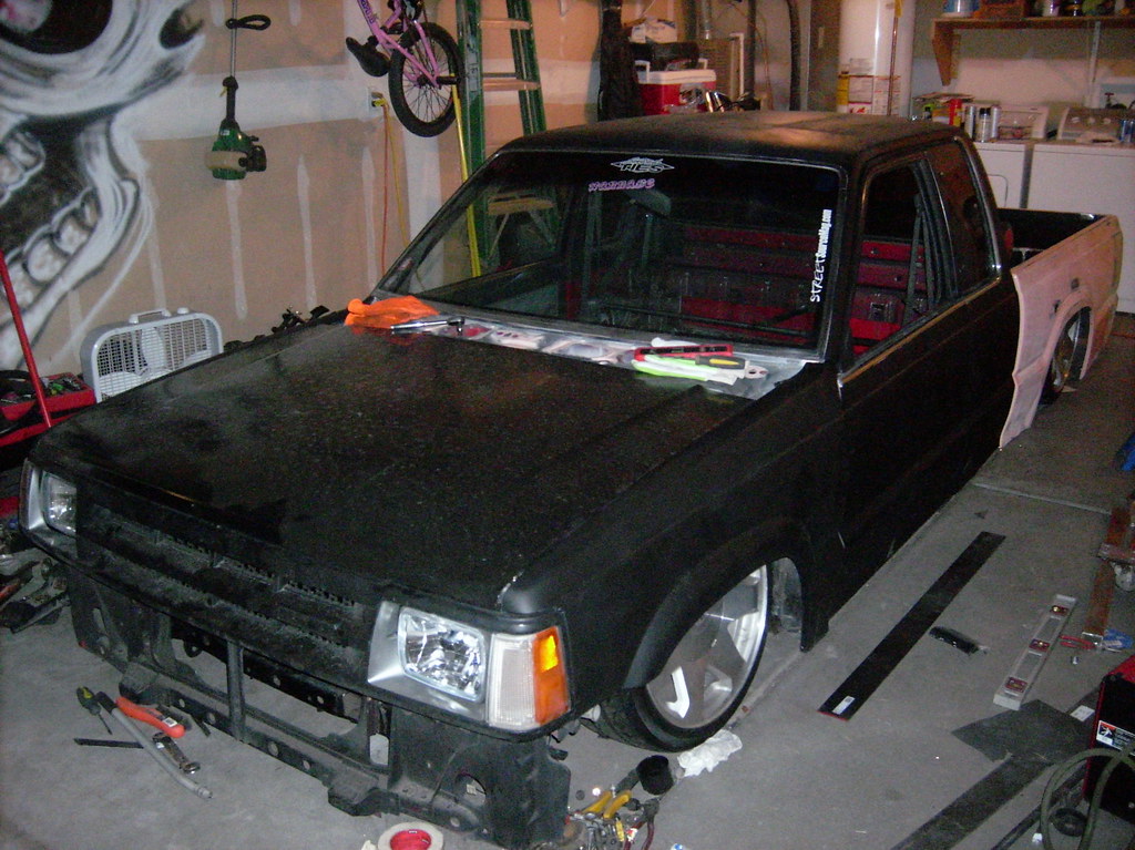

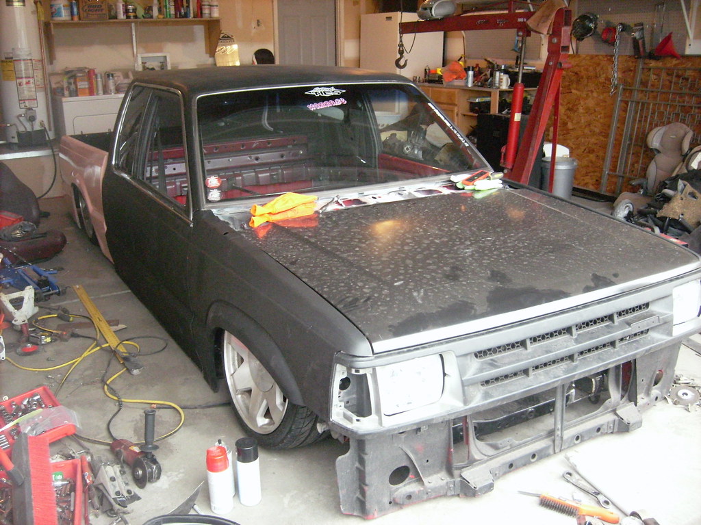

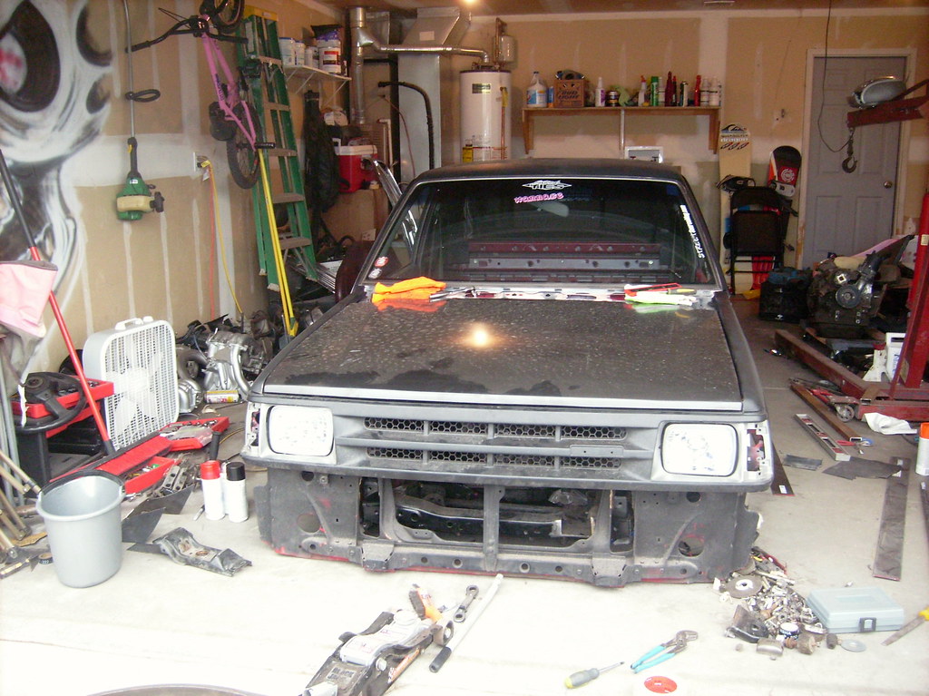

the last pic from work last night. first thing this morning i snapped a pic with the doors back on. this is before i trimmed the rest off the front.

i cut the rest of the cab off and got it laid flat doors. just need to finish capping it, but i have a plan for that..

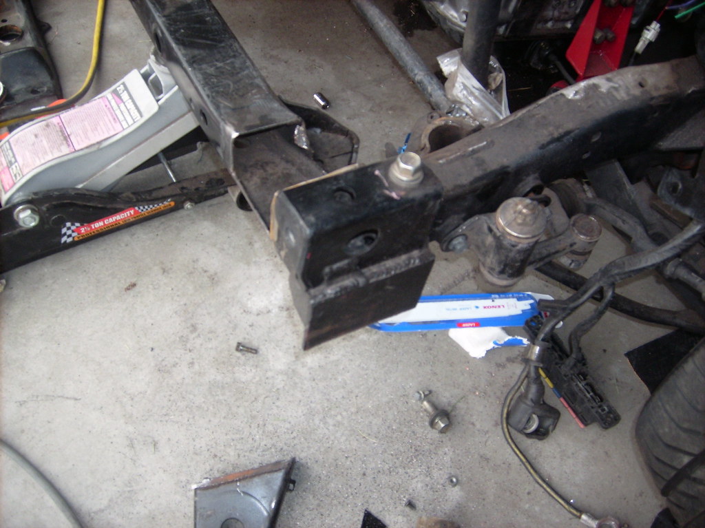

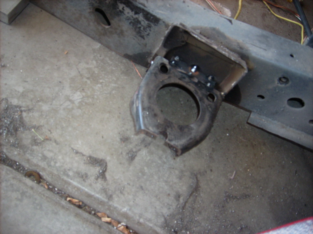

i also cut the rear cab mounts off and lowered them 3 1/4". this way i can space them up to the right height to meet the existing mounts and make sure i am flat door. some of u may be saying well chris, u only needed to go 3 inches so u are technically bodydropped past the frame. to those of u that r smart enough to figure this out, congratulations, and the reason for this is because, well, i thought it woul be the best way to assure i am dragging doors lol.

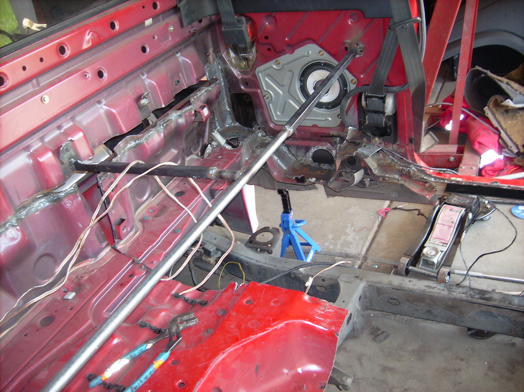

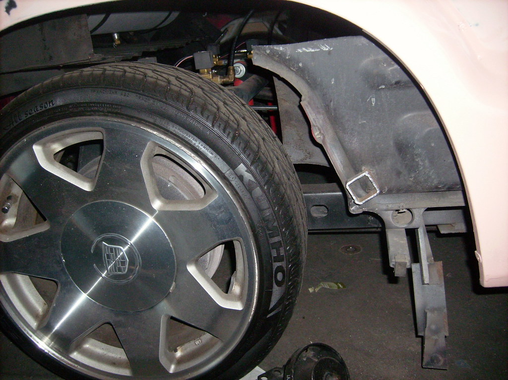

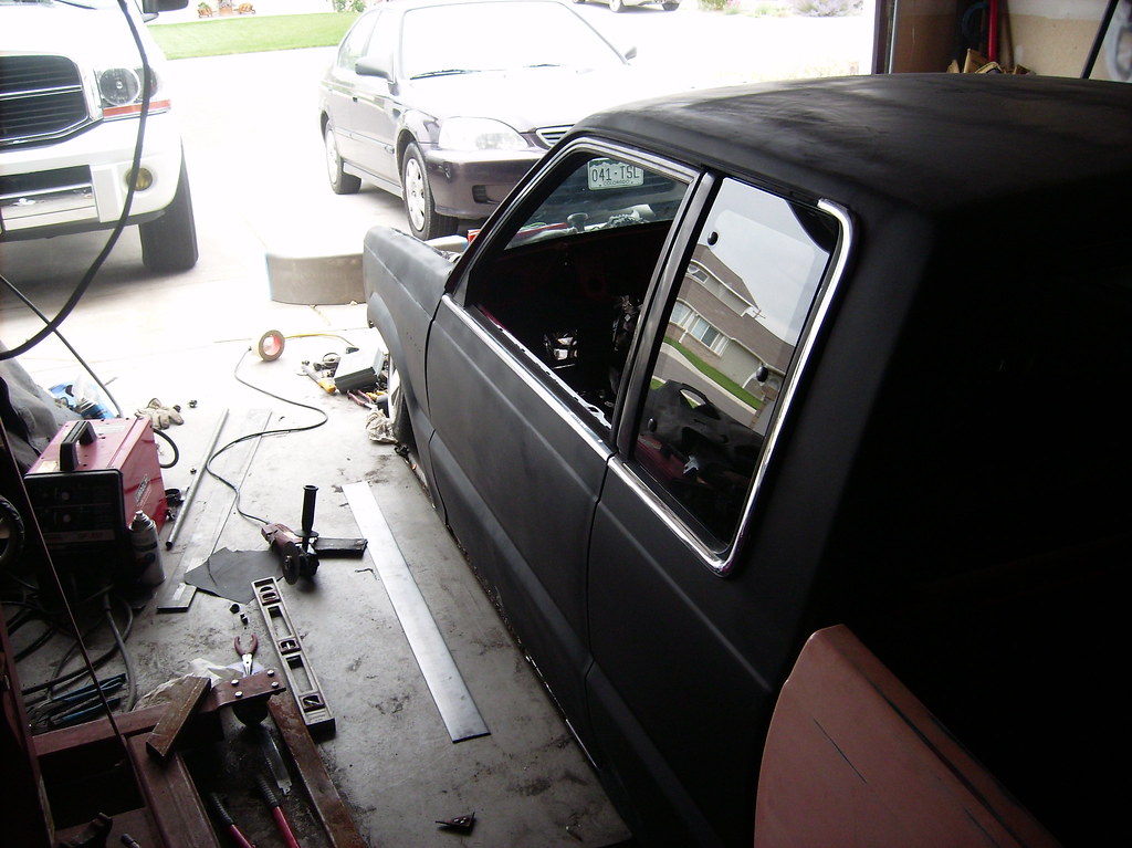

good penetration..
monster truck..

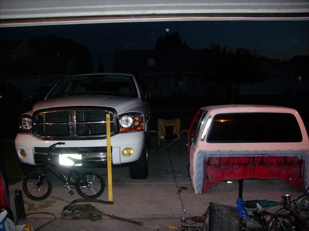

i also got the rest of the cab masked off and painted flat black. hopefully i can get the cab back on tomorrow and do some more welding. i had a problem with my welder not putting out gas, but after my buddy nick came over and tinkered with it for about an hour, we got it figured out...
